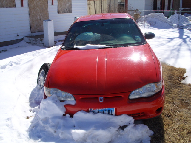

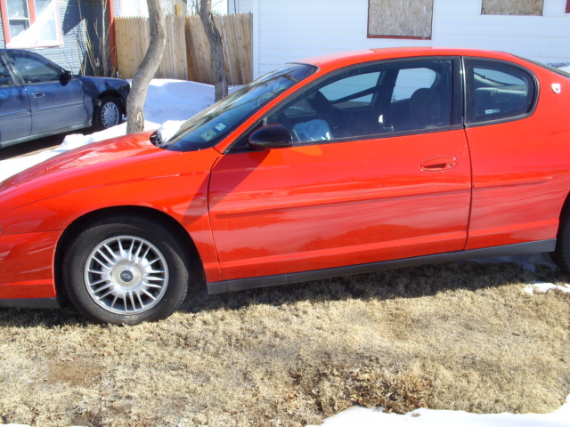

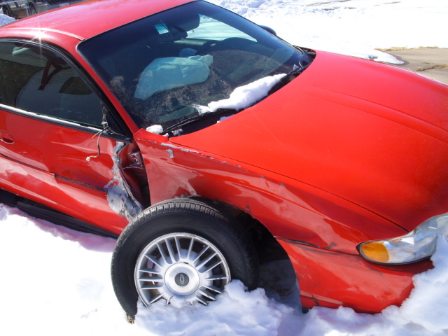

        Picking it up tomorrow. Here are some pics of the car. Taking it by a body shop whose owner I trust to determine if the damage to the door hinge/pillar area is worth fixing. If it's not too bad, might just replace the fender, door, mirror, lower control arm or strut, and keep it rather than swapping everything over to the '97 Monte.
          It's hard to tell, but that window frame does look like it's not meeting with the roof like it should. It could be the top of the door is tweaked from the impact since there are a couple wrinkles in it. I'm no body guy or crash pro, but it doesn't look too bad to me. In fact, the more I look at it, the more I would think you could fix it and have a nice car, but again, I'm no body guy or crash expert.
