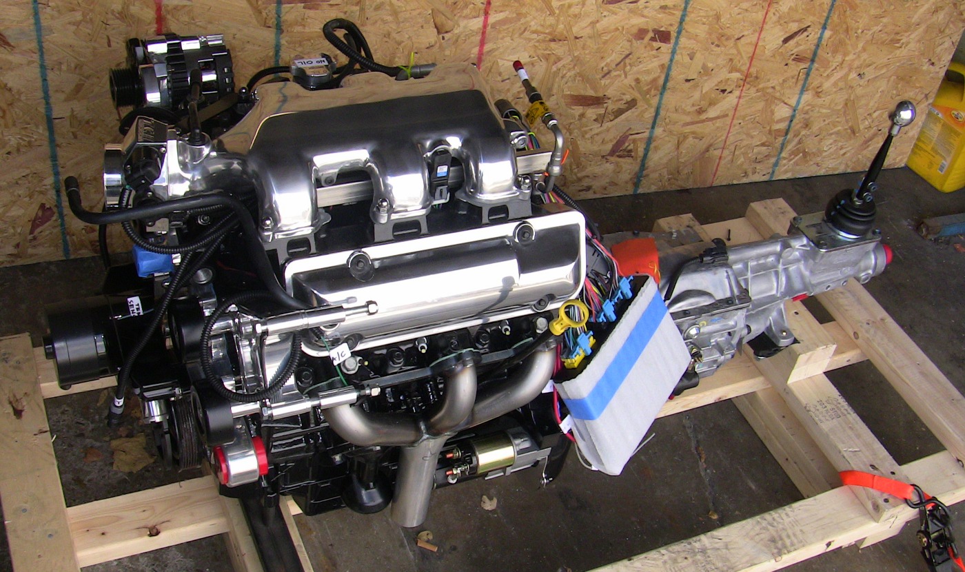

                          There are lots of people running 3X00 engines in MGBs. Most are using the Ford T5-Z transmission but a few are using 700R4s. My MGB has an LZ9 3900 with a Ford T5-Z transmission. Below is a picture of an LX9 with a 3400 UIM and Ford T5 just before being shipped. The complete assembly, as shown, is going into an Austin Healey and weighs 470# including starter, ALT, electric water pump, A/C bracket, headers, wiring harness and ECM.
                          You can see some completed 3X00 MG swaps at http://britishcarconversions.com/photo

                          • #28
                            That is a beautiful piece of work, Marc!
                            • #29
                              Agreed, looks amazing!
                              • #30
                                Thanks guys. Everything on that engine was either polished aluminum or low gloss black paint/powdercoat. The picture doesn't do it justice. He will be ceramic coating the headers once he decides the final length of the down tube.
                                The 3X00 engines are nice in small RWD cars. Excellent performance, reliable and great fuel mileage. Can't ask for much more than that.
