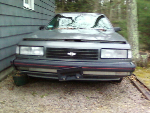

    OK, this is just another one of my stupid ideas that I'm throwing around....Has anyone ever thought about doing an AWD swap on their FWD 60 degree powered cars? I was day dreaming last week about doing a conversion on my 1990 Chevy Celebrity Eurosport and I was honestly thinking about taking the transaxle out of an AWD Pontiac Aztek. Would that be possible to do? Has anyone driven an AWD Aztek, and I don't know if it'll need custom fabrication to make it fit

              I've heard the STE's System won't last up to the abuse....I just want to run atleast 300hp to make the rice boys in my neighborhood shit themselves. The car has sentimental value to me, but I can't leave it like any normal car out there, I'm keeping it looking original, like a regular wagon, the ultimate sleeper Click image for larger version
