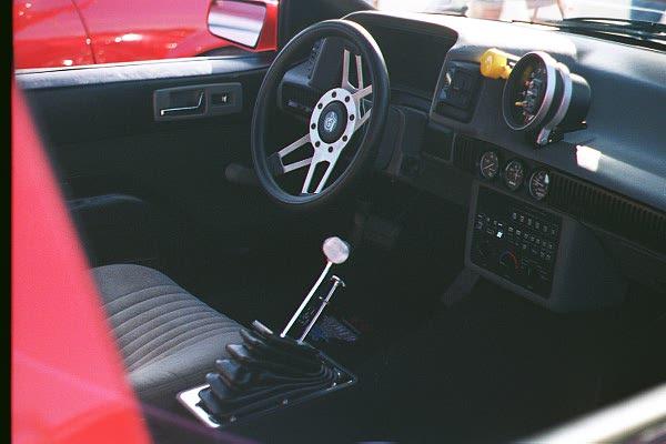

                          If those 2 transmissions are set up anything like the Aztek/Rendevous (or any other Versatrak setup), then it isn't true AWD anyway. It is still primarily FWD, but power is transferred to the rear diff when the front starts to slip. As far as RWD Berettas go...
                            I remember a really really all out race Beretta, tubbed, caged, ect that got posted a long time ago. It was a really nice shade of yellow, IIRC.
