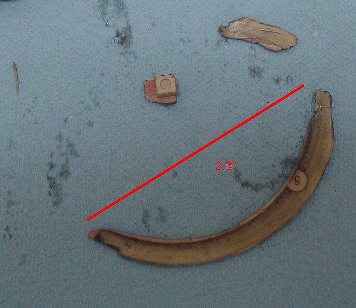

                  Found parts, lovely. There was one stuck by the filter port on the bottom of the tranny in what appears to be some sort of check valve. I assume that was giving me my loss of pressure like symptoms.
                  Here is a pic. What is this and how bad it is going to suck?
                    Ah...Themz a Plastique Thrust Washer.... Typically they dont cause immediate failure....But it would be nice to have in there...If it runs ok now then dont worry too much about it, you have time. But keep in mind that you will be grinding metal to metal where that thrust washer was meant to be.
