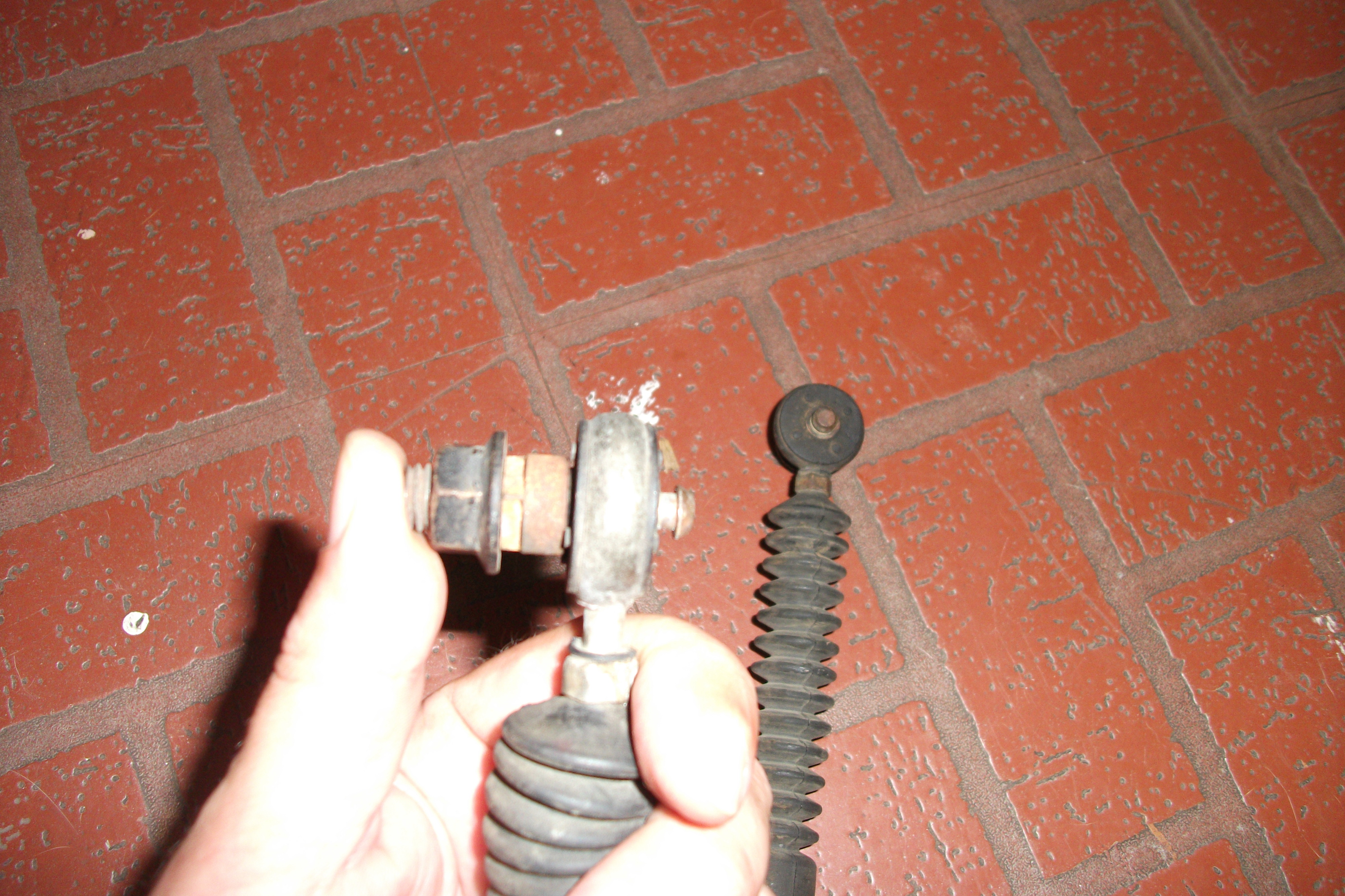

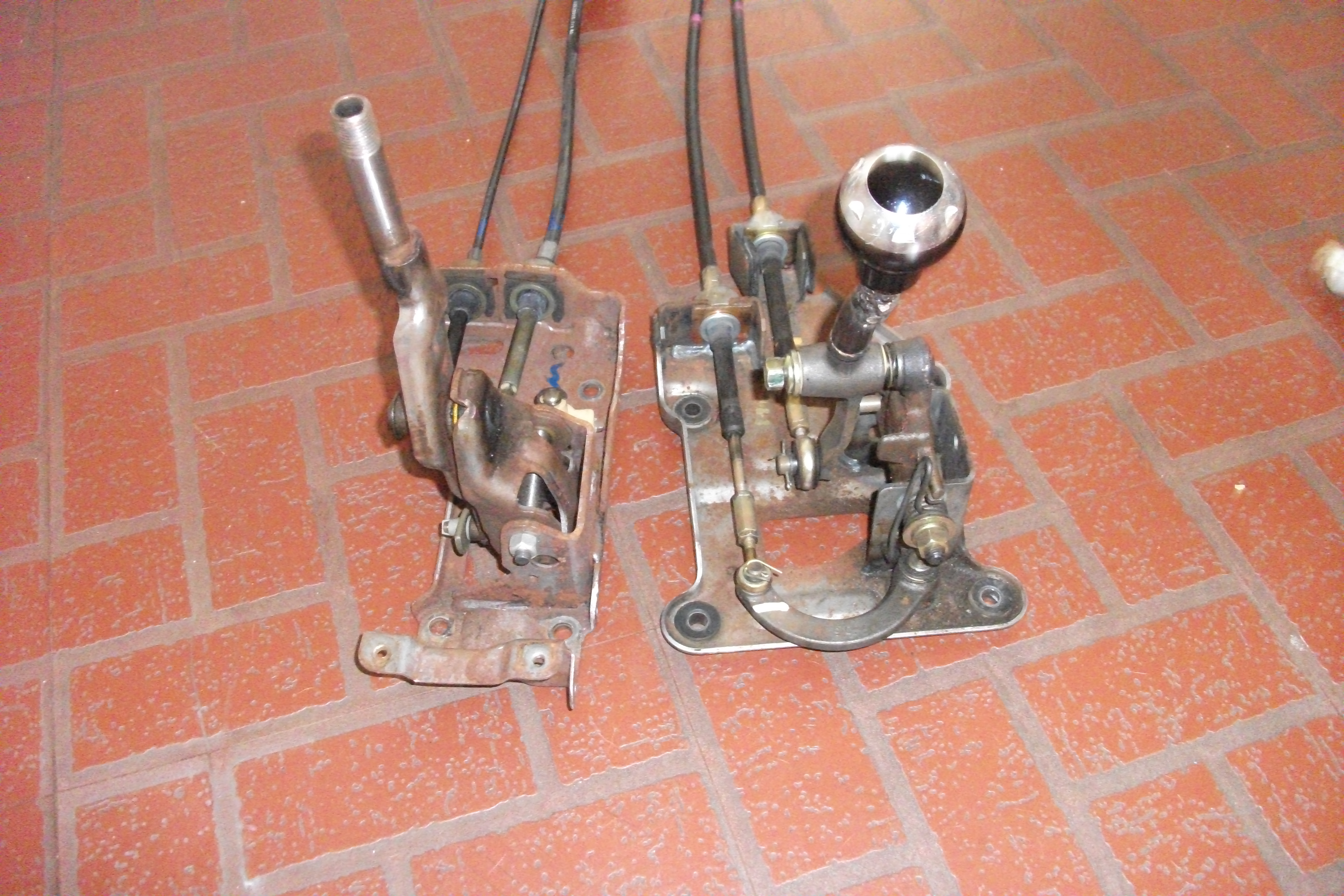

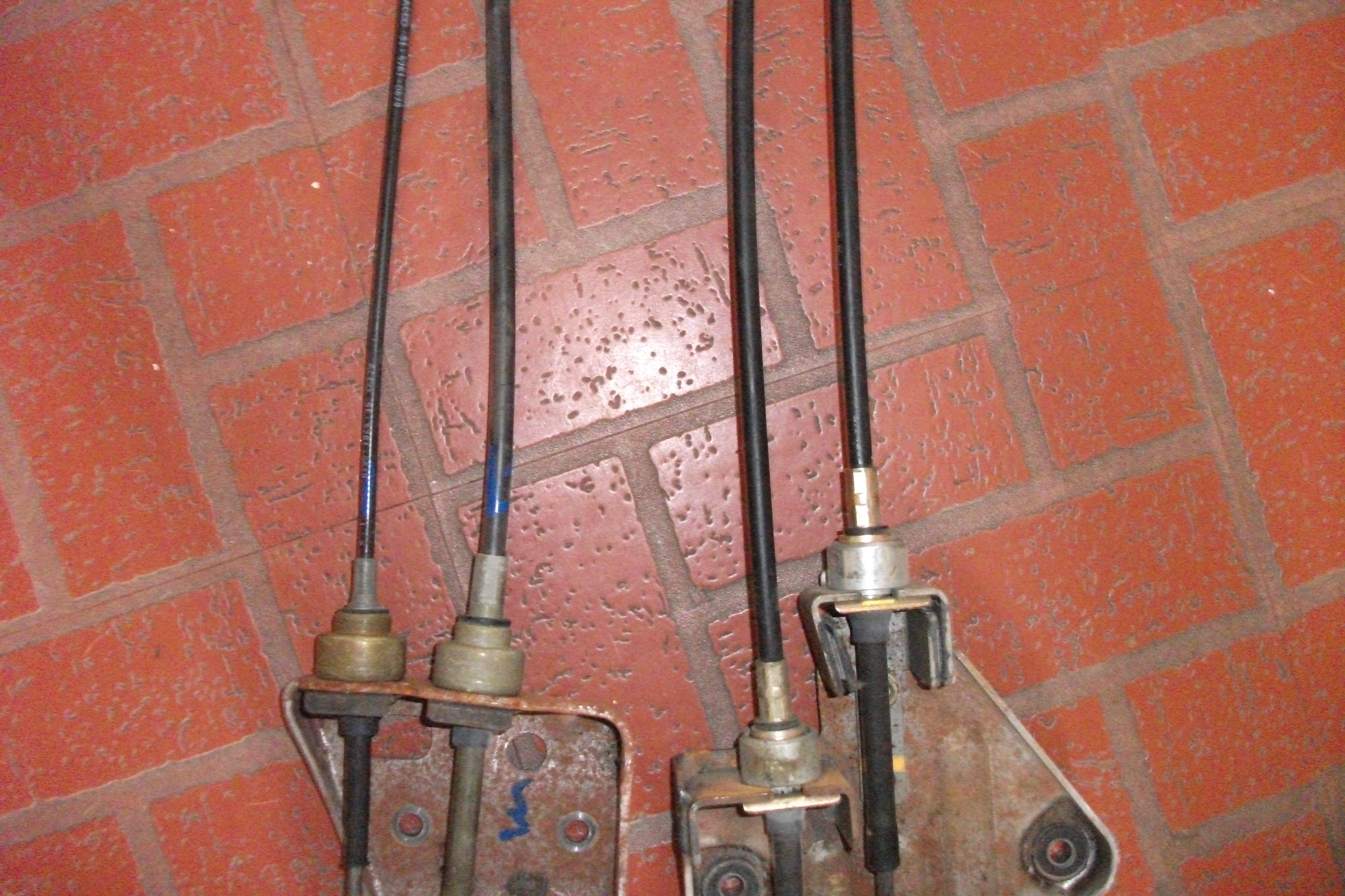

          Well, here they are, the 1995 VR4 short throw shifter and cables. The first pic is the mitsu shifter side by side with a 1995 gagt that had the HO quad and 5-speed. I will have to re-drill 2 holes to mount this. The second pic is showing the differance in the cables thickness. The mitsu cables are way thicker than the GM's cables. The mitsu's shifter is also smoother and a better feel thru the movements. The third pic shows the mitsu's cable ends that go to the tranny. I disconnected the pins to show how they fit, a perfect fit. I am going to make an adjustable bracket to be able to fine tune the shifter cable mounting location on the tranny.
