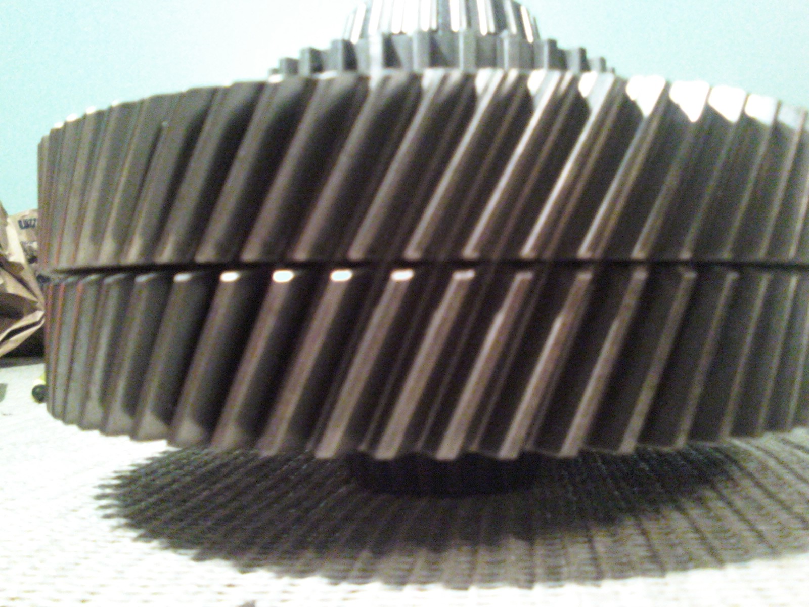

    I just recently noticed these differentials have different tooth patterns and count. I havent counted them but its obvious from looking. The smaller dif with the coarse teeth is from a 90 ish beretta while the slightly larger finer cut teeth is from a achieva, supposedly its 3.94 but I havent actually counted it yet.

    3.61 and 3.94 were the only 2 FDR's available in the HM282..
    I wouldn't use the 3.94 diff, i made that mistake and wasted a year of racing trying to break into the 13's.. went back to the stock 3.61 trans and almost broke into the 12's.
    If you have the cash i'd just swap the good 4th into a 3.61 trans and enjoy it.

        the '89 Quad 4 trans is the best match for a V6. You get the better 4th gear (1.03) and the better 5th gear (.72) with the 3.61 FDR.
        '89 Quad 4:
        1st...3.50
        2nd...2.19
        3rd...1.38
        4th...1.03
        5th...0.72
        FDR...3.61
        I had a '93 W41 trans on my cammed 3500,
        1st 3.50
        2nd 2.05
        3rd 1.38
        4th 1.03
        5th 0.81
        Axle 3.94
        65 MPH was like 3000 or 3500 RPM in 5th gear, it was miserable. I was getting about 12 MPG on the highway.. lol
        I put back in the V6 trans, here are the stock ratios..
        1st 3.50
        2nd 2.05
        3rd 1.38
        4th 0.94
        5th 0.72
        Axle 3.61
        That with a welded diff got me .7 faster in the 1/4 mile, similar trap speeds.
        I would just use the V6 trans, leave the Quad 4 trannies on Quad 4's.
