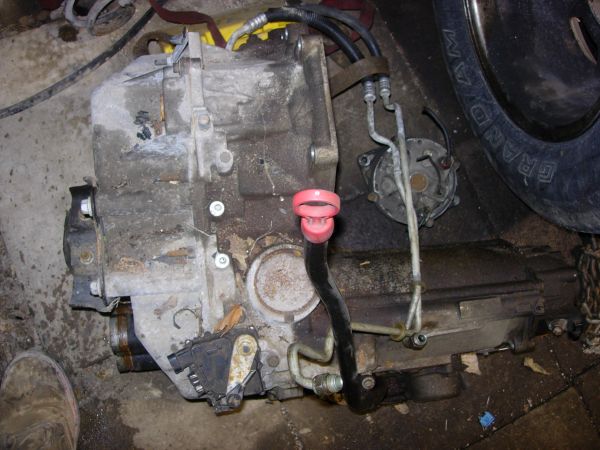

    i am going to be turboing the 3400 with my friend the only thing we are unsure of is the transmission .. will the 1998 gtp tranny work i believe it is 4t65e-hd.
    one opinion is that it needs nothing but a performance mount and wiring harness.. others say it wont work...
    i can pick it up today if it will work.
    while its true, you will need a mount due to the fact the a GP is a W body and an alero is a N, i don't see why it won't work, especially if you're willing to work with the harness portion of the issue.
    not sure about the axles...

      alright man thanks ..
        anyone know about the axles?
          You also need a way to control the tranny, as I'm not sure the electronics/controllers are the same between the 4T40/5-E and the 4T65-E.
