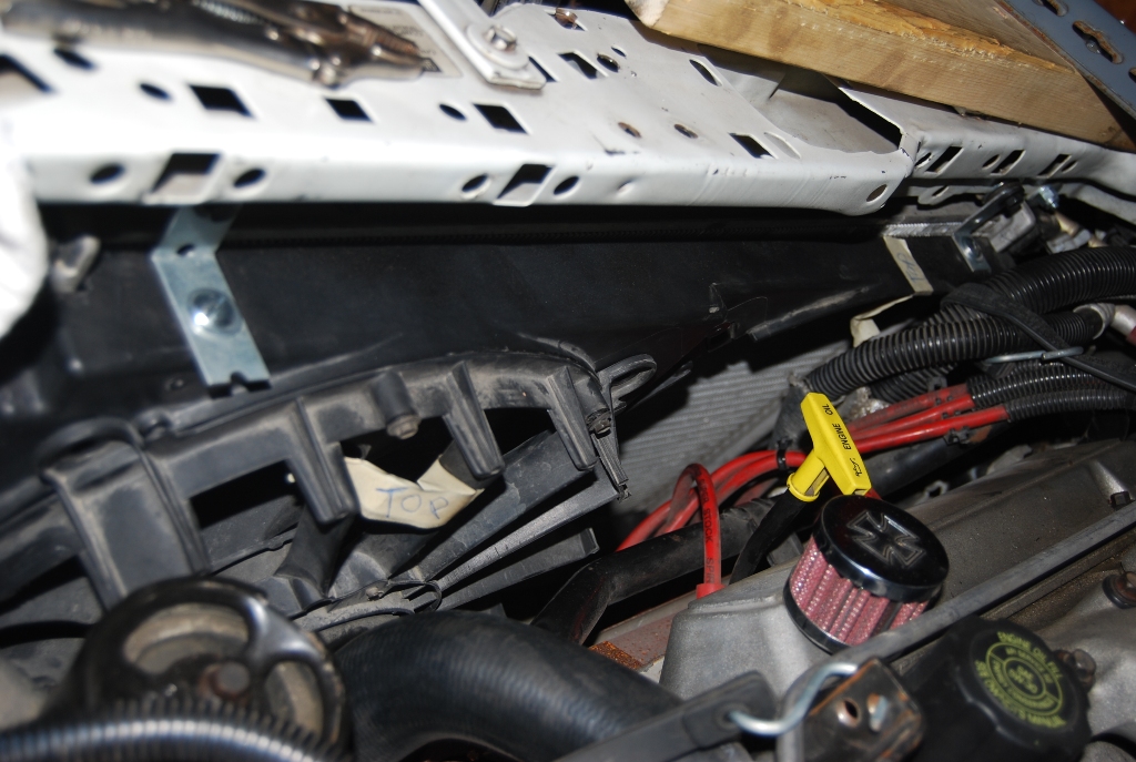

                      HOLY CRAP!! Got it out on the road and what a difference!! Shifts are quick and precise. The downshifts are almost instanious, even the 3-1!! It almost feels like downshifting a stick shift at WOT without taking your foot off the gas. Floor it, less than a second later, bang! You're off! I just installed a TransGo kit, drilled the seperater plate and added Valvolene Dex VI (full synthetic). WOW!
                      Here's a pic of the nearly completed cooling fans.
