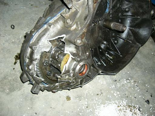

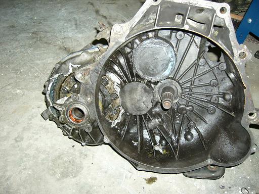

                    I have a couple pics of mine :
