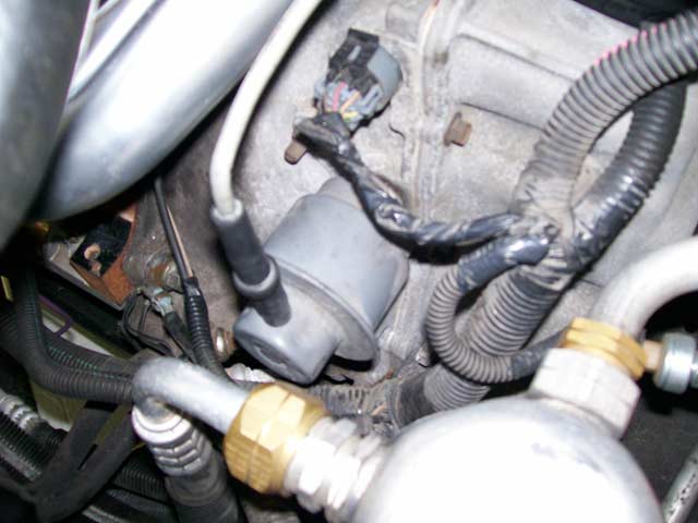

                                use the rubber 90* it will fit perfect.
                                A pic of mine a long time ago.. Remember I have vac lines tapping off for the hvac controls, yours doesnt have all that crap.
