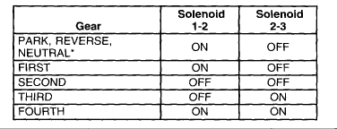

    here is an apply chart also, when the solenoids switch on
      That chart is exactly what I was looking for...thanks.
      Then what I'll try next is putting a tester in line on both circuits to see if both grounds are actually "off" when it's commanding 2nd. I think if there is a short somewhere in the line, the test may actually show continuity, but not distinguish if the wires are making contact elsewhere to ground out..... which though the PCM commands second, a ground is provided somewhere that isn't supposed to be, if 2nd is supposed to be "off/off".
