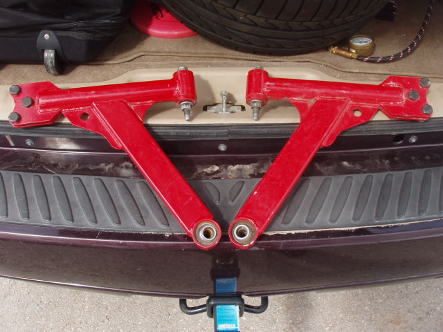

        Here is a quick pic of the control arms......weighing in at 6.7 lbs as they are pictures I would say they are pretty close to stock which at roughly 7-8lbs, I know the 99 aluminum arms are 4lbs bare, not sure on total weight with the bushing and what not but i would imagine 5-6lbs......

          those do look nice. Are those from that Overkill racing something or another guy?
            I'm honestly not sure where they are from (manufacturer wise)

                    Those will break in a matter of no time. I suggest that you get those gussets reinforced. That could be a serious crash is they break.
