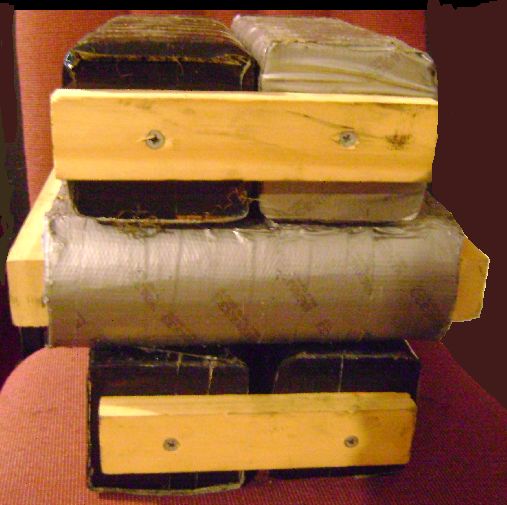

      (6) You can use Jack Stands if you choose to support the car while thrashing around underneath...but instead...to be supremely safer...build yourself some of what I call "Car Stackers" like I created and then you can lower the car down onto them with two car ramps first as a base on either side of the car. Then you will have ever so much more room to move around from front to back ...especially when installing the Emergency Cables and not have to worry about yanking the damned car down on top of you while trying to break so many difficult bolts loose. When I was doing the LS1 brake conversion on this RS, I was getting so physical at one point that I damned near pulled the car off the jack stands! So I thought I better make something that is adjustable and stack-able...similar to Leggos, that I could place further back under the square frame members and then settle the car down on top and not have to worry about jacks or stands slipping.
      So what I came up with is what I now call “Car-Stackers”. These consist of -8- eight square support members made up of two sections of 4"X4" treated fence post wood cut to a length of about 10-12" long. I wrapped these four-by sections completely in Duct Tape and then fastened them together on the post ends with short sections of oak furring strips, using high carbon steel masonry screws to stabilize them side by side. This way I could use them in many ways of different stacking combination on top of two truck ramps and get the car lifted to the height I wanted to work at. This was very helpful when putting in the emergency brake cables and installing the rear axles and gear box work. Most importantly, it was safe and helped make concentrating on the work easier. This also meant that I would have more room to move around under the car and gain access to places the stands would usually block. The attached photos will illustrate what they look like.
