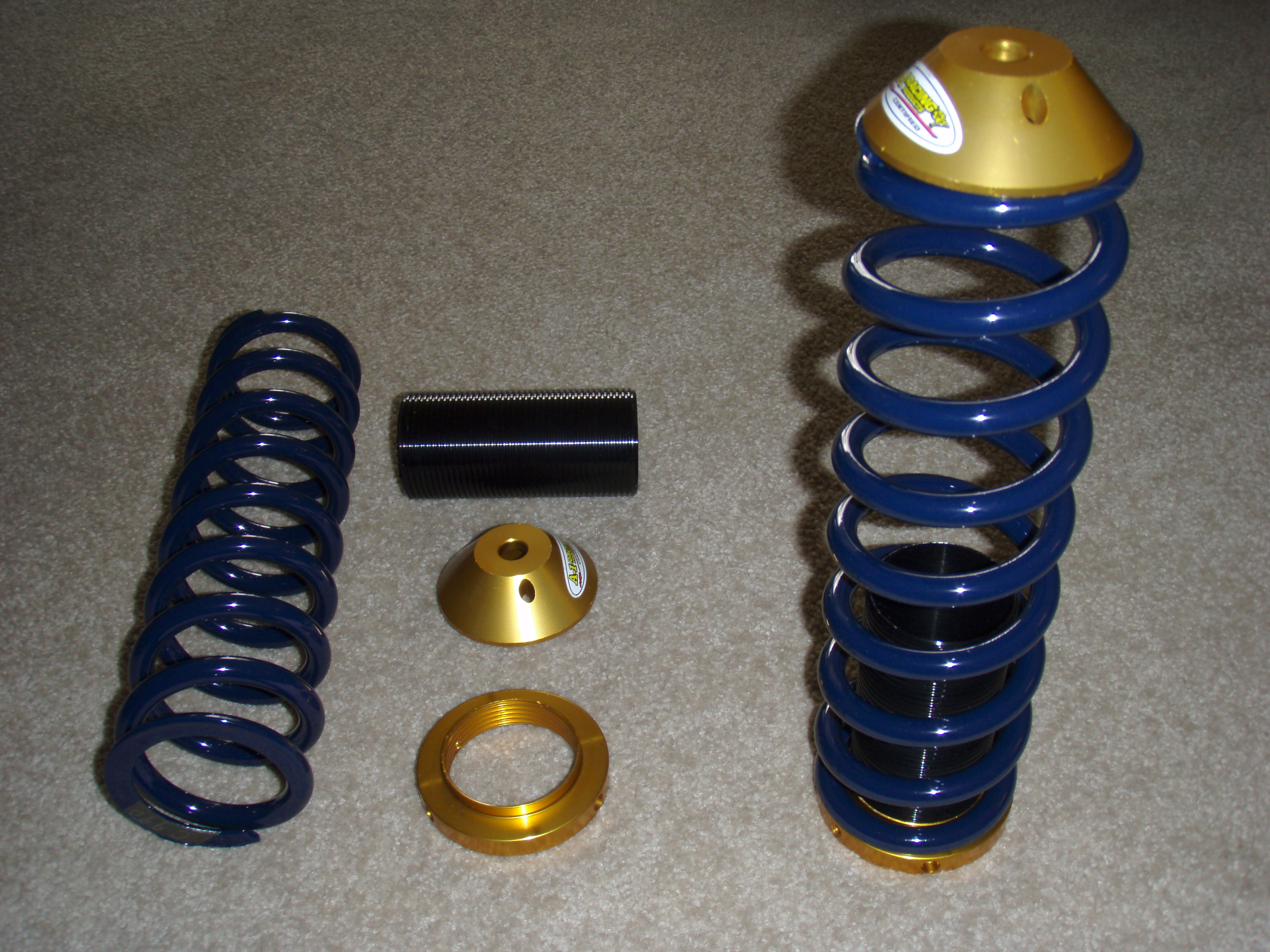

    I'm one email away from ordering a rear coil over kit for my GTP. I'm almost set to go with 200 lb springs but was wondering if you guys have any opinions or feedback for those that have done it. 200 seems a good compromise but maybe 225 is better. I think 250 would be to hard... suggestions??

    Years ago I bought a set of rear FFP coil-overs. Michael was shipping them with 250lb/in, said that was close to stock... I went with 275s. Myself, I am very happy with them, glad I didn't go with the 250s. It is a bit stiffer but not uncomfortable or incompatible with the stock fronts.
    Just my opinion tho...
    Tom..
    PS: my car is a 93 Z34.
      right on thanks for the reply! good to know the stock leaf is about 250 as a spring rate. I dont want it any softer than stock so I may up the rate to 250. anybody else before I order??

            Well, here is a cut and paste of a couple of comments Michael (Fast Forward Performance) sent to me in e-mails:
            "Springs.... they are available in 25# increments, so there is nothing
            between 250 and 275. The 275s aren't all that harsh. You can tell it's
            not stock, but I haven't had anyone ask me if I just took the springs
            out."
            "As for spring rate, I usually ship them out with 250 #/in springs. That
            seems to be pretty close to the stock GM FE3 suspension (stock on GTP
            and Z34). I have gone all the way up to 300 #/in... that's right on the
            edge of overpowering the damping of the KYBs. 275 is noticeably stiffer
            than stock suspension and the ride tends to be a little on the choppy
            side."
            Hope this helps,,,
            Tom...
              Thanks for the feedback guys. I ordered the kit today! I will take pictures of the job and post a walkthrough when I get time to put it in so we have something on here and not just the wbody forums.
