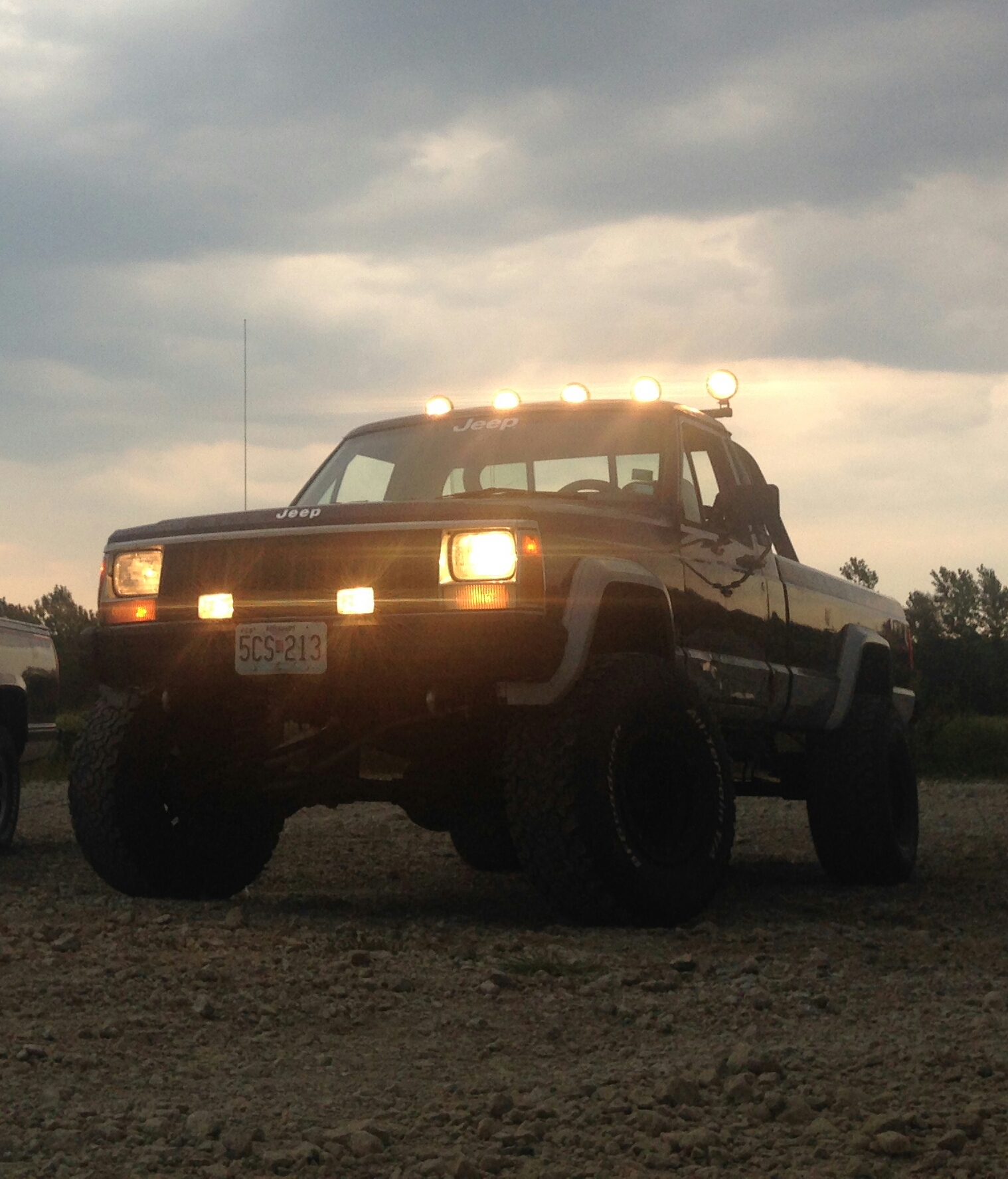

    This is my first post here but I am wanting to swap my 1986 jeep Comanche 2.8l Carb for a 93-95 Camaro SFI. The engine swap in itself is easy, so iv'e heard, but where I am running into trouble is how am I going to make the SFI work? I am pulling the motor out of a manual to avoid the electric transmission shift stuff as my truck is a manual right now. My plans for this motor is a t3/4 turbo kit, forget pistons, megasquirt.... ect. But first i'm going to have to figure out how to get the SFI to work in the first place. People have suggested the TBI but I don't want to go that route. I like the way the SFI intake looks on the engine and it is a better system IMO. So any help would be appreciated as to what I am going to have to pull from the donor vehicle, or perhaps a link to a write up of someone who has done this, because i can't seem to find any. But anyways im glad to be a part of this forum now Here is my truck!Click image for larger version
