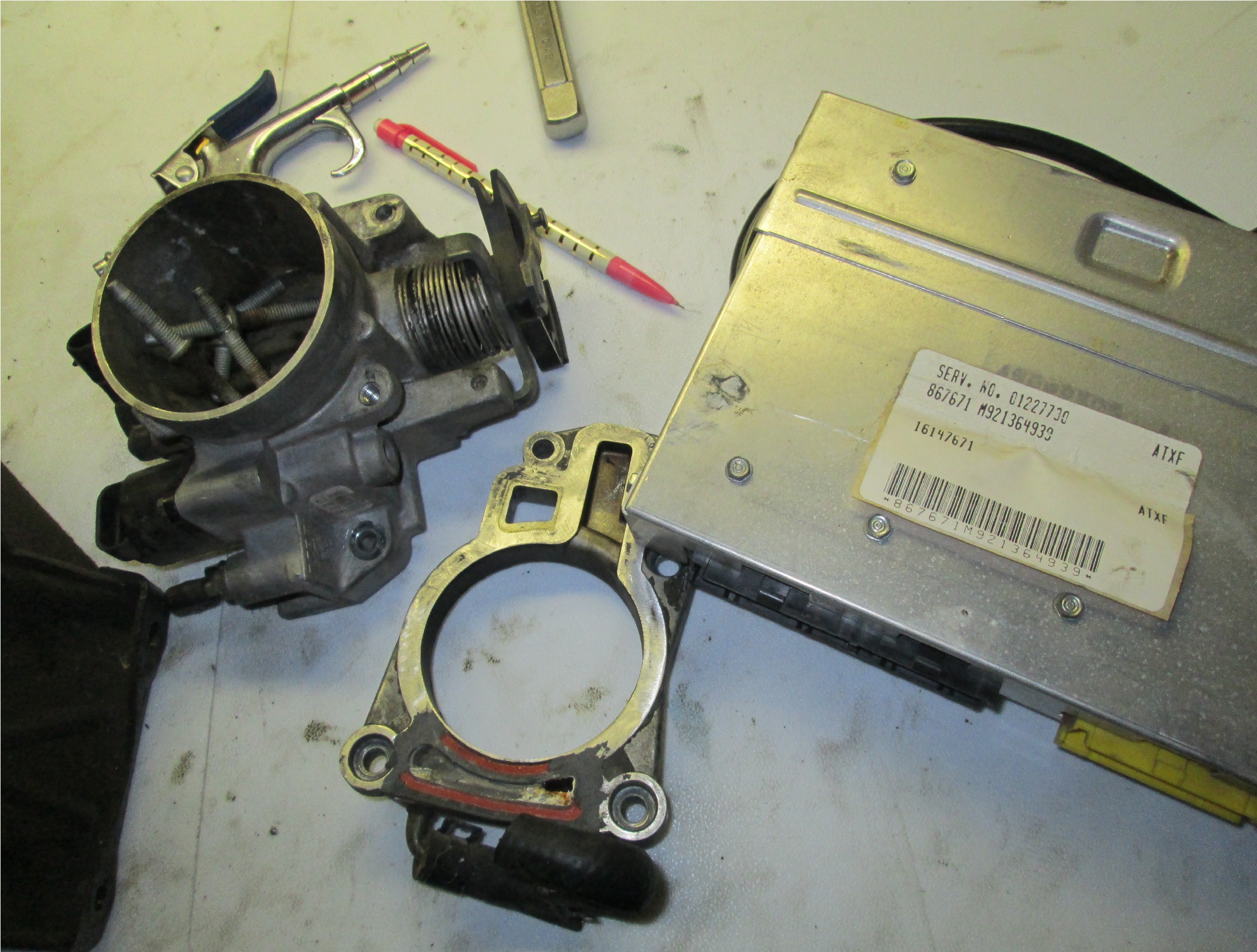

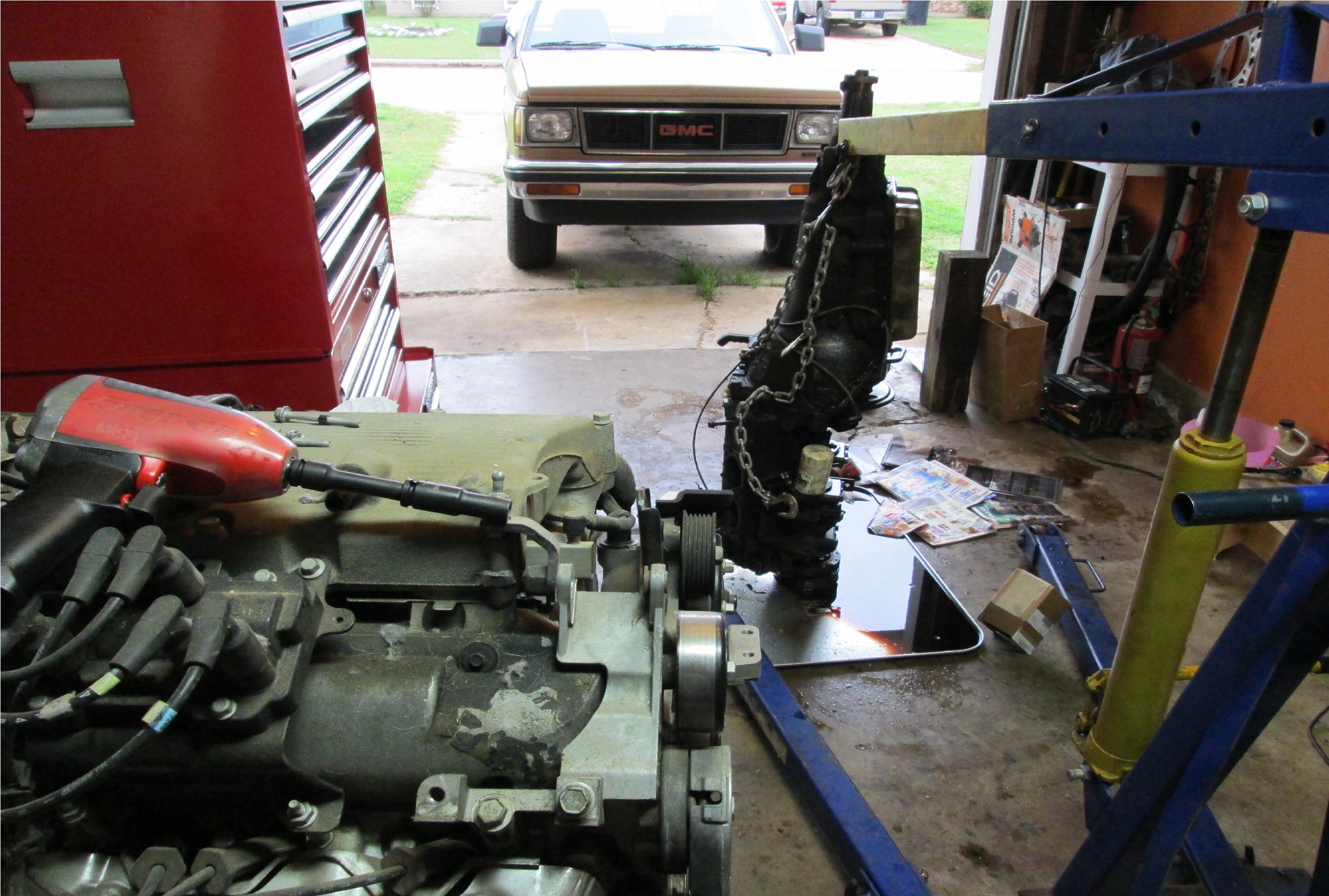

ID:	377998 The 2.8/700r4 came out and the crank has spun main bearings. I'm going to swap in the 3500 now not later. I have a '7730 ecm and i just picked up a LX5 throttle body from the pick n pull. Now I just need to clean things up and start mocking up the 3500.Click image for larger version
