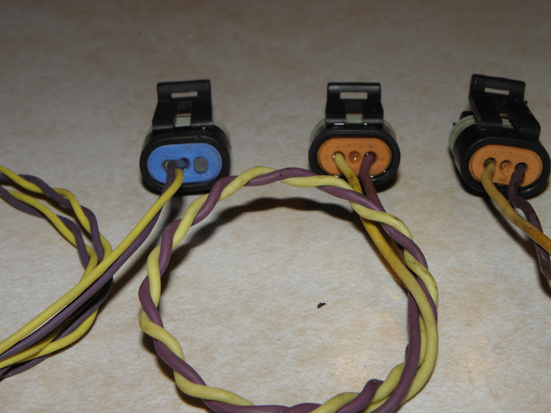

ICM 3 pin connector crank pick up wiring
Most don't have shields and are wired A - C. However, either configuration will work as B & C are both grounds.MinusOne - 3100 - 4T60E
