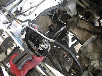

        First time a pulled the engine (cam swap into original 3100)

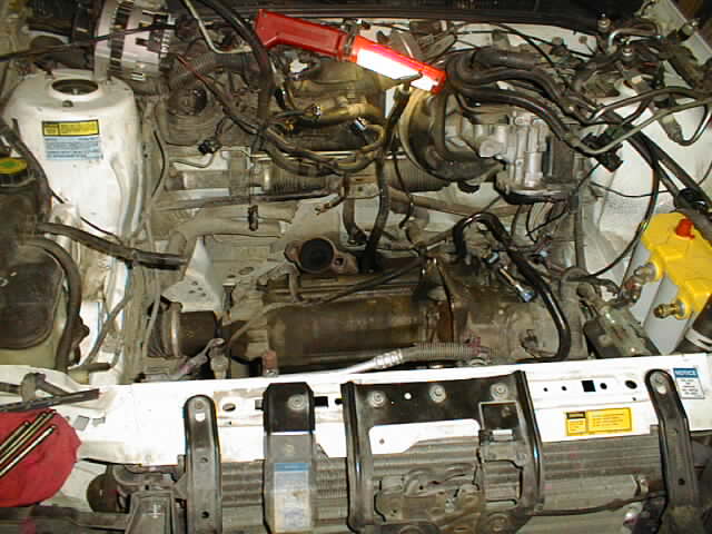

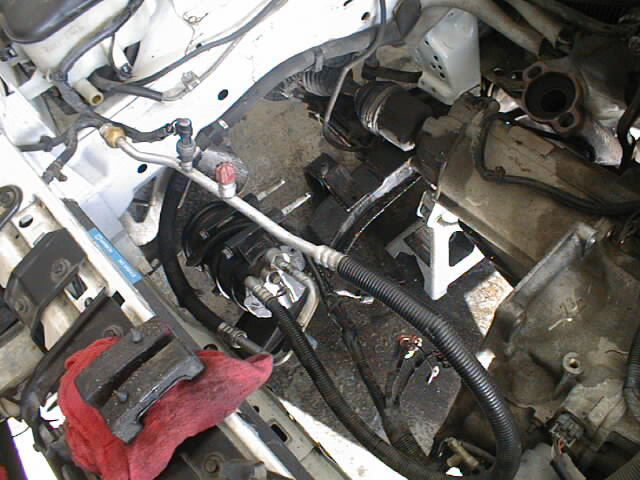

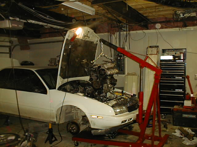

        Next time I pulled the engine (3400 swap)
          you can get that back 18MM with a few extensions from the passenger side fenderwell, the AC compressor should slide down out of the way, check that everything is undone, and clear about 3 or 4 times, i alsmost always forget something. except the last time i did it. and if it looks like it could accidentally break with removal, just remove it. as in the rear O2 sensor. pulling off the alternator will help to, and put a jackstand under the transmission to keep it level while you pull out the motor, otherwise it will lean over and take up that little bit of space on ther passenger side.
