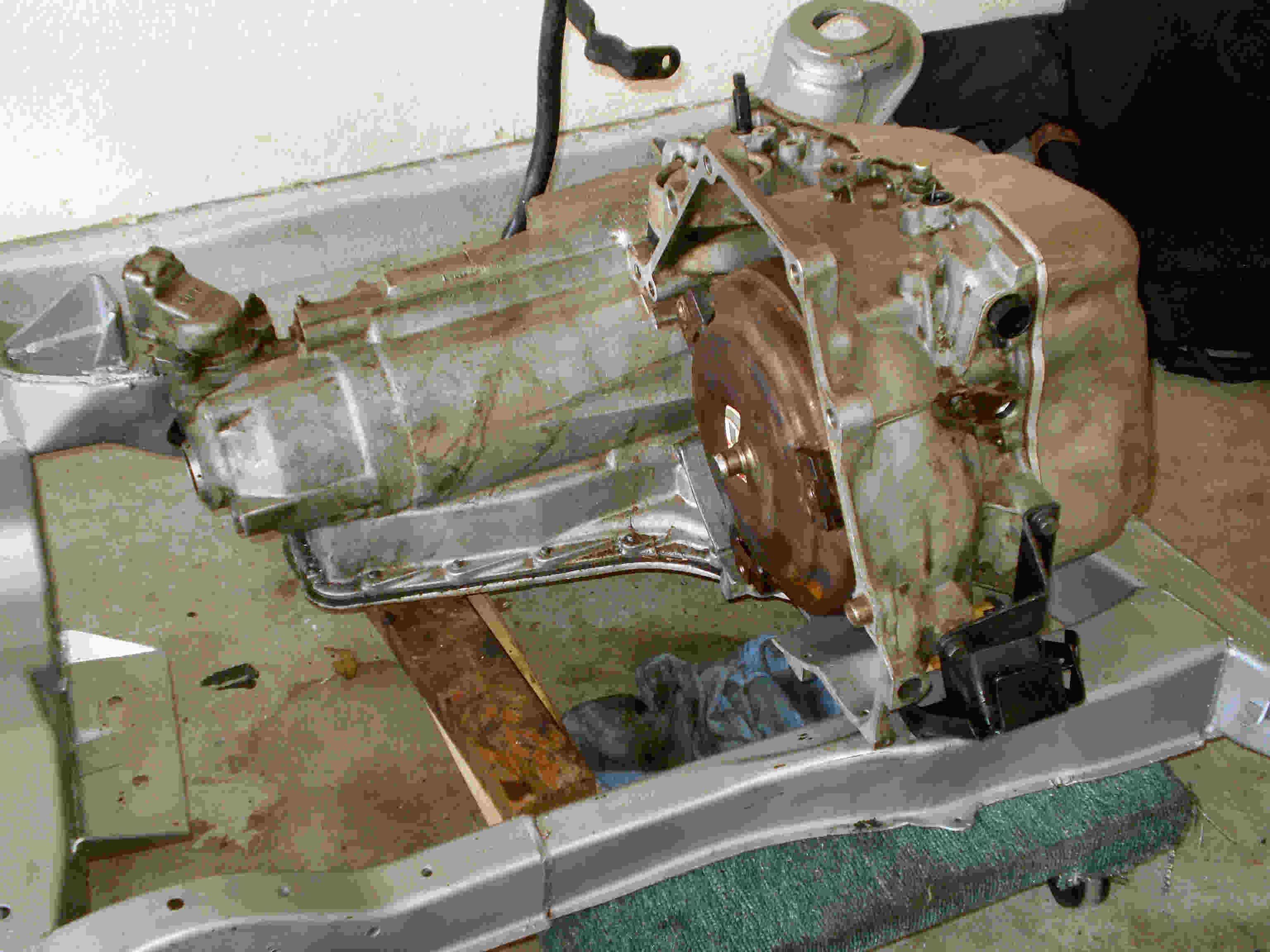

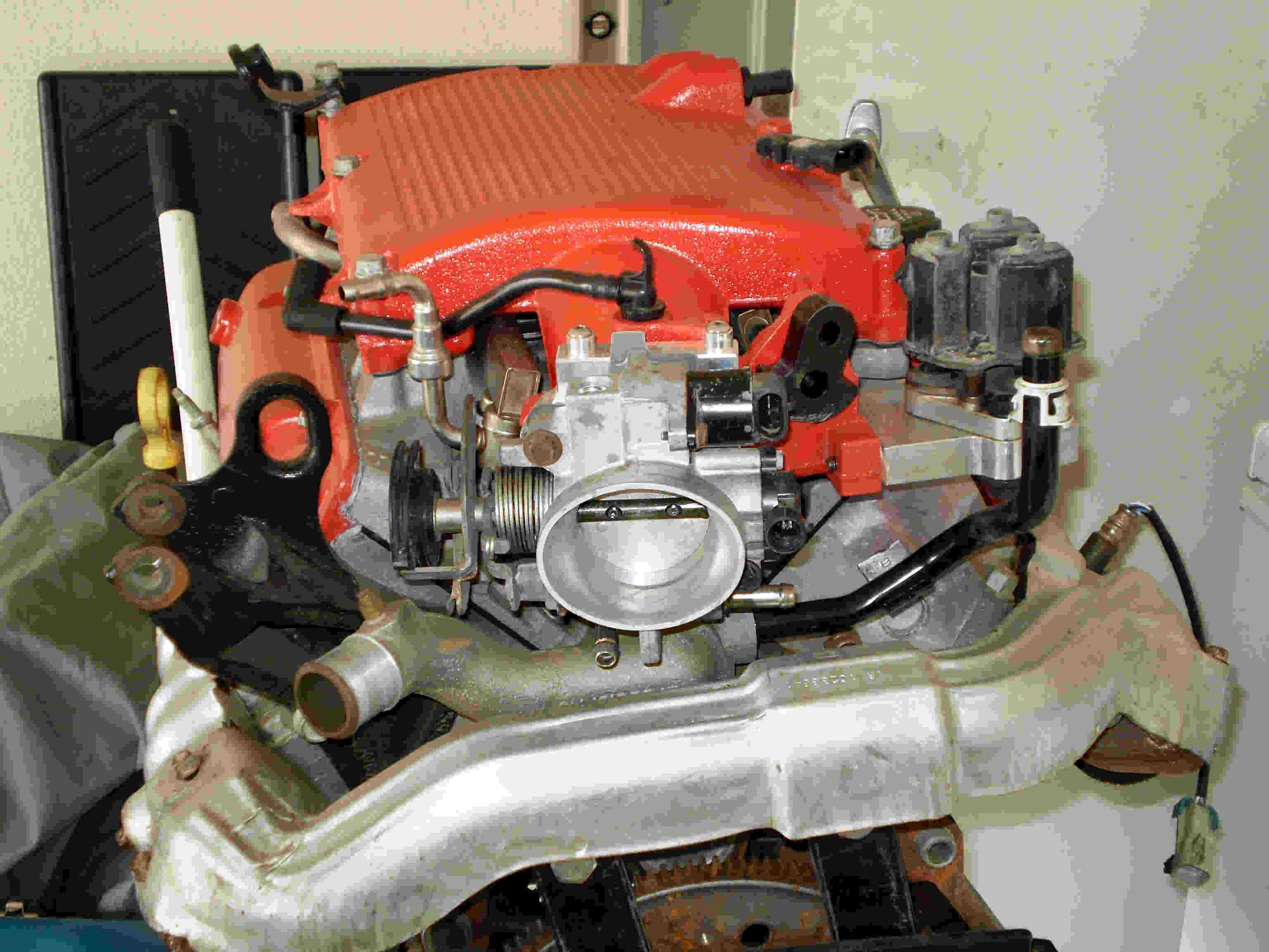

    • #47
      Got my tranny on the cradle. Tomorrow I will mate the engine and tranny. I have to redrill the motor mount holes in the cradle as it originally had a Duke and a 125-c mounted. Here are a few pics of the engine and one of the tranny on the cradle. Once the engine is mated, I'll go down to Autozone and rent a harmonic balancer install tool. Need to get that overspray cleaned up on the pic showing the timing cover.
      • #48
        Awesome . . . but you should have avoided getting paint in the water pump chamber area of the cover.
        • #49
          Are you thinking that the paint will be a problem in that area? When I bought the timing cover, it already had been painted black. I never thought about whether the paint would come off with all that heated water rushing through it.
          • #50
            I know ethylene glycol makes a pretty good solvent and pieces of paint can abrade seals. If it were any other vehicle, I might not care so much as repairs would be easier. Seeing as how this is going into a Fiero, I would leave no stone unturned with respect to build details in order to avoid any unnecessary trouble.
            • #51
              I'm sure that amount of paint could possibly clog or at least partially clog a heater core as well.
