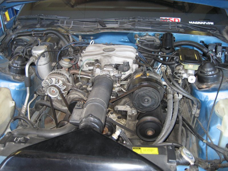

            Congrats on the swap!! Not sure if I skipped over this but which acessory brackets did you use? If you used the 2.8 brackets do you have a picture from the front showing the acessories?

              Yeah I used all of the 2.8 bracketry for the accessories, the only problem I had with them and the 3.4 front cover/waterpump was the one hole on the power steering bracket that had to be enlarged. The heads and block had all the other holes in the proper spots. I do have some pics of the swap and some after but I'll have to look to see if any show the accessories well. If not I'll take some closeups for you.

                the reason I would like to see a pic is because I would like to see how much room the A.C. takes up.
                  Here is a picture before we pulled the motor (hopefully it uploads), not like it looks much different now but anyways. The A/C compressor is the old style (short and fat) above the power steering. If you want some close ups and clearance pics let me know what you want a picture of and I'll get them for you.
