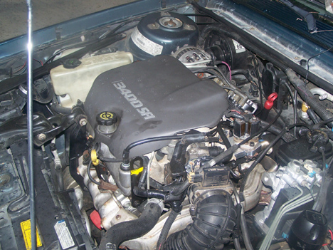

                        yep, they were 3/16 braided wire crimps... in this pic you can see the box that the throttle cable runs into on the firewall behind the tranny dipstick... Overall it works and doesnt look half bad it opens and closes all the way, but I wanna find a way to completely avoid that lil box...i think its stupid as crap
