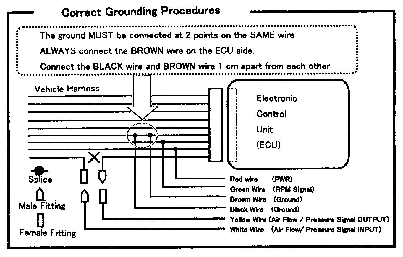

            hey any luck on the MAF setup? i figured out all the other wires and on the MAF i know which wire to use on that i just don't know which of the 2 sets of wires to use on the apexi afc.
            it is either yellow and white or pink and orange? which set do i use?

              ok not to steal any this thread but ive been looking around and trying to find a wiring diagram for a apexi afc but no luk can any one help me? Thanks
              • #22
                I doubt that you are stealing a thread that is 2 1/2 yrs old... See if this helps:
