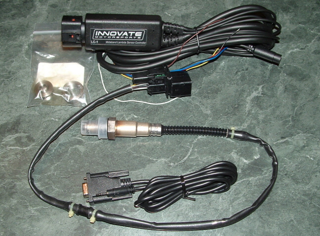

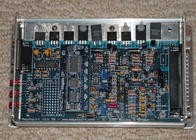

                      Figured I'd post a couple of pics of my own MS2. Unfortunately it's not in the car yet, but I assembled it myself and ran tests. Seems ok so far. I'm curious as to how your set up works. I'll be running similar config myself, but i'm not sure how much, if any, the stock ecm will do.
                      And of course running the Innovate LC1 as well.

                        How bad was the assembly? And did you have any prior circuit building expereince?
                        95 Beretta- Lg8 Daily Driver
                        • #27
                          They are pretty easy to assemble. I had virtually no prior experience and just followed the directions. It is pretty straight forward. The big key is to build the stim board first. It is much easier, and will allow you to test various parts of the build as you go along.
                          I had some help building mine from a guy who does them but I'm pretty sure I could have done it without help.

                            Hey there,
                            It's relatively easy, but I've built and designed circuit boards before in high school and college. I didn't get the stim board, so I have no experience with that.
                            Like the manual says, if you have no experience, practise on some cheap starter kit first.
