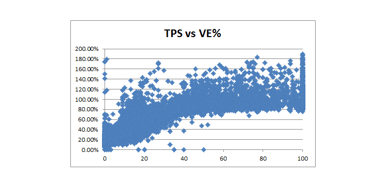

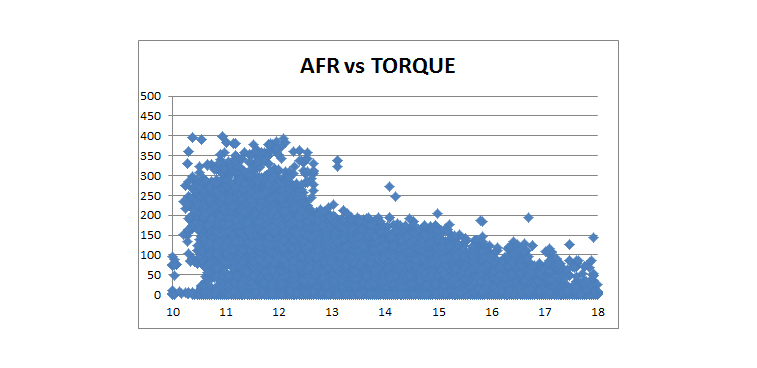

    More data. In the AFR vs Torque chart, we can see the reduction of torque as the AFR gets richer on the top end. Spanning from 10.5 to 12.1.
    Also noting 37% throttle appears to be the threshold for spool up/boost.

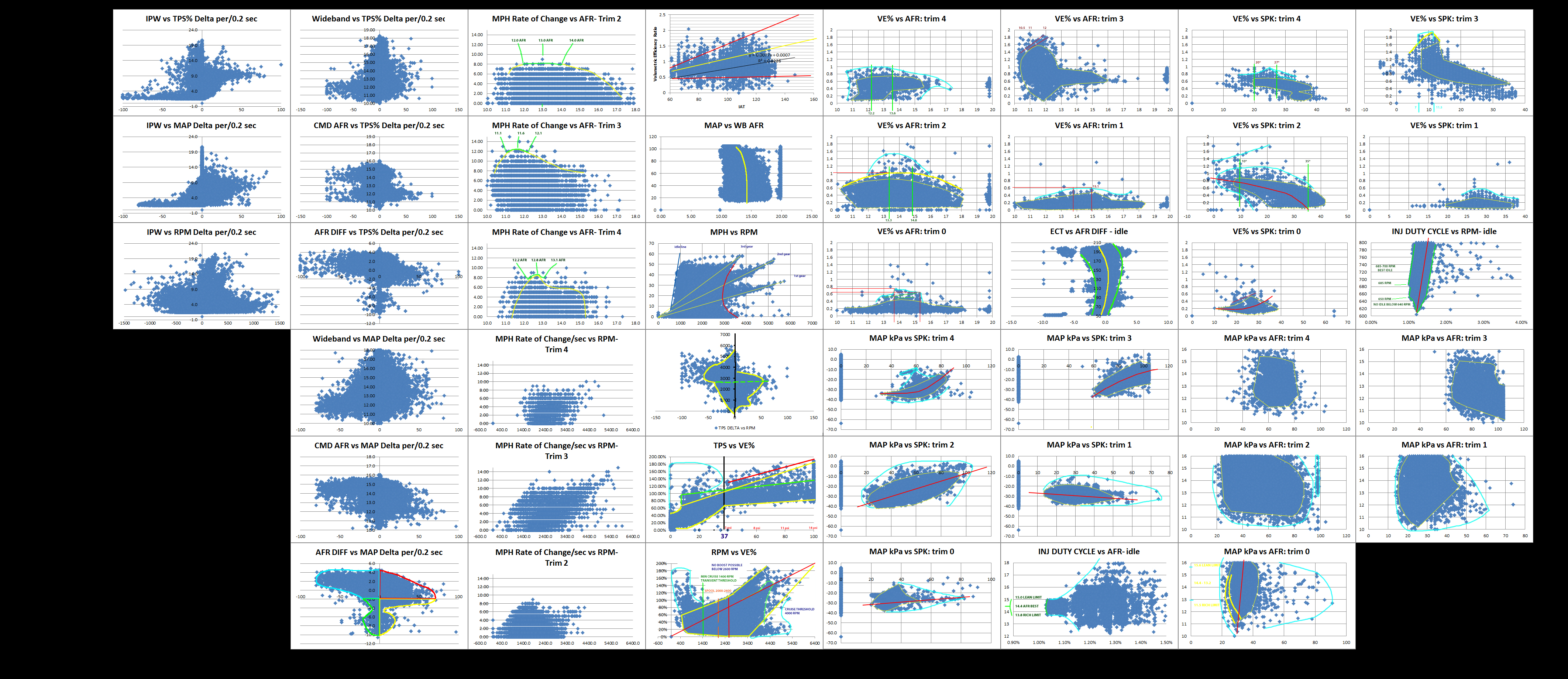

      Here is a large image with all the scatter charts, a lot of data.
      trims are 0-idle, 1-decel, 2-normal/cruise, 3-wot, 4-high rpm

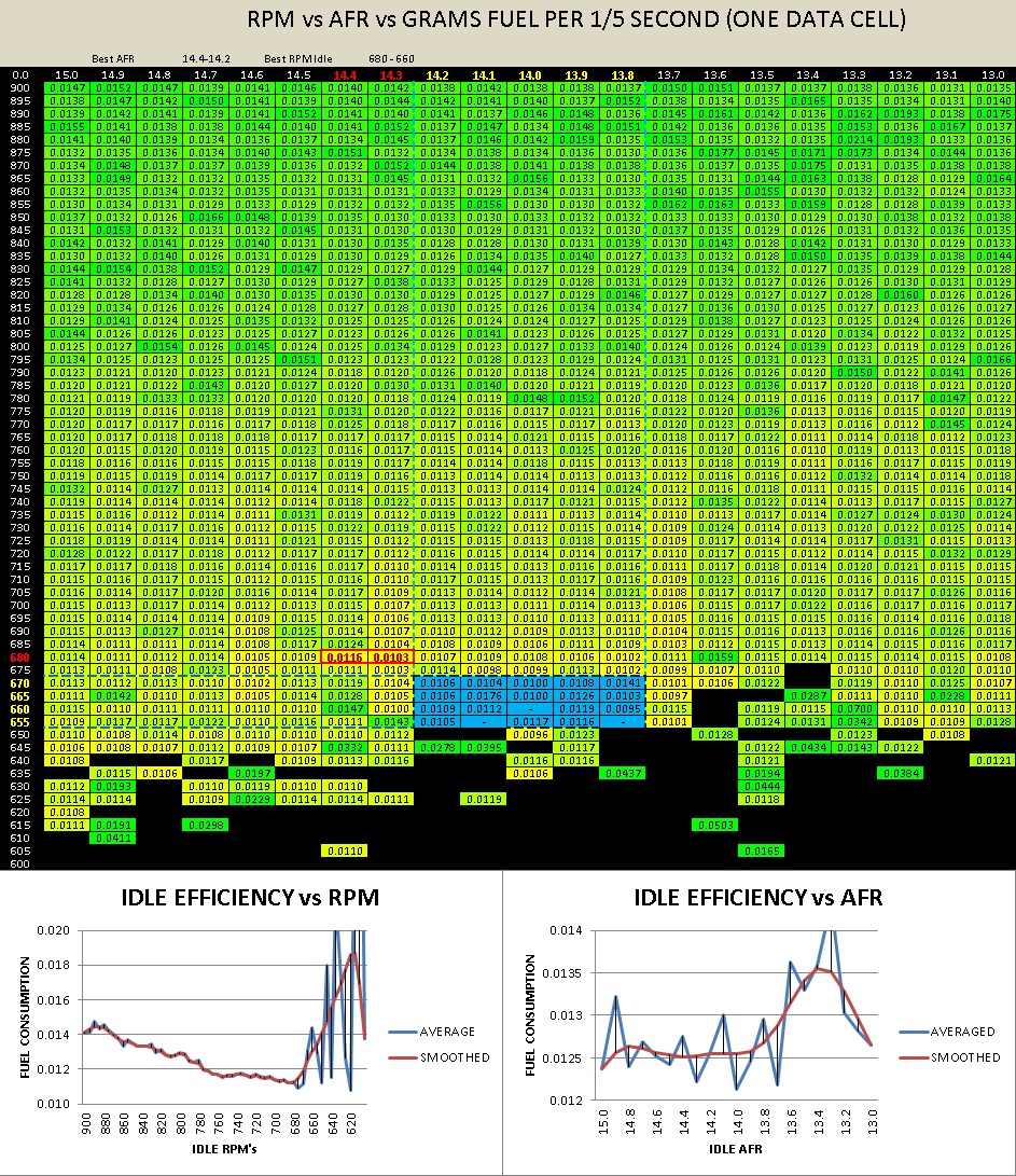

        Data analysis of Idle conditions and fuel consumption. Used injector data with IPW against RPM's to determine the precise amount of fuel delivered over a fixed amount of time. The time frame is 1/5th of a second which is the length of 1 data cell. HPT logged 5 frames per second.
        Fuel injector per cylinder fires once per every 2 RPM's. At 700 RPM the injectors fire 350 times (per cylinder). If the IPW is 2.1 msecs, then a 36 lb/hr injector will deliver 0.00454 grams of fuel per 1 millisecond opened.
        ((IPW * 0.00454) * (RPM / 2)) / 300 = FXgs
        FXgs = Fuel amount in grams per 0.2 seconds
        ((2.1 * 0.00454) * (700 / 2)) /300 =
        FXgs = 0.011123 grams per 0.2 sec
        FXgm =
        Since we are dealing with idle conditions, a static average is effective. Noting the actual fuel delivery can be off a little as long as the same formula is used across the board.
        Here is the table that I came up with using the massive data file from my 3100v6 turbo. Referrenced against AFR as well.
        Best fuel saving idle is at 14.35:1 AFR at 670 RPM
