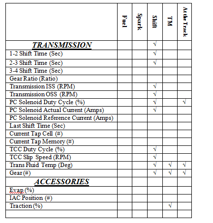

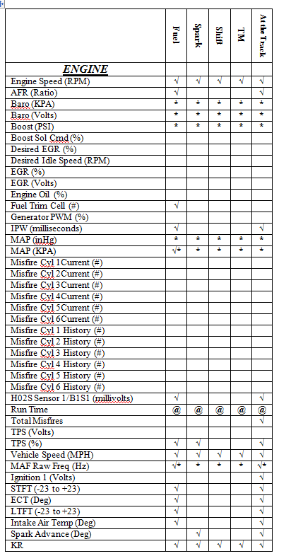

        here's a screenshot from the file to show you what should be datalogged

          sweet man, Thanks! now i know what to log. if i want to lean out my tune based upon the data i log... What value(s) do i start changing?
