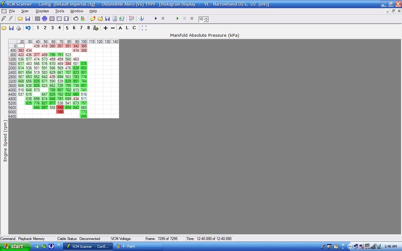

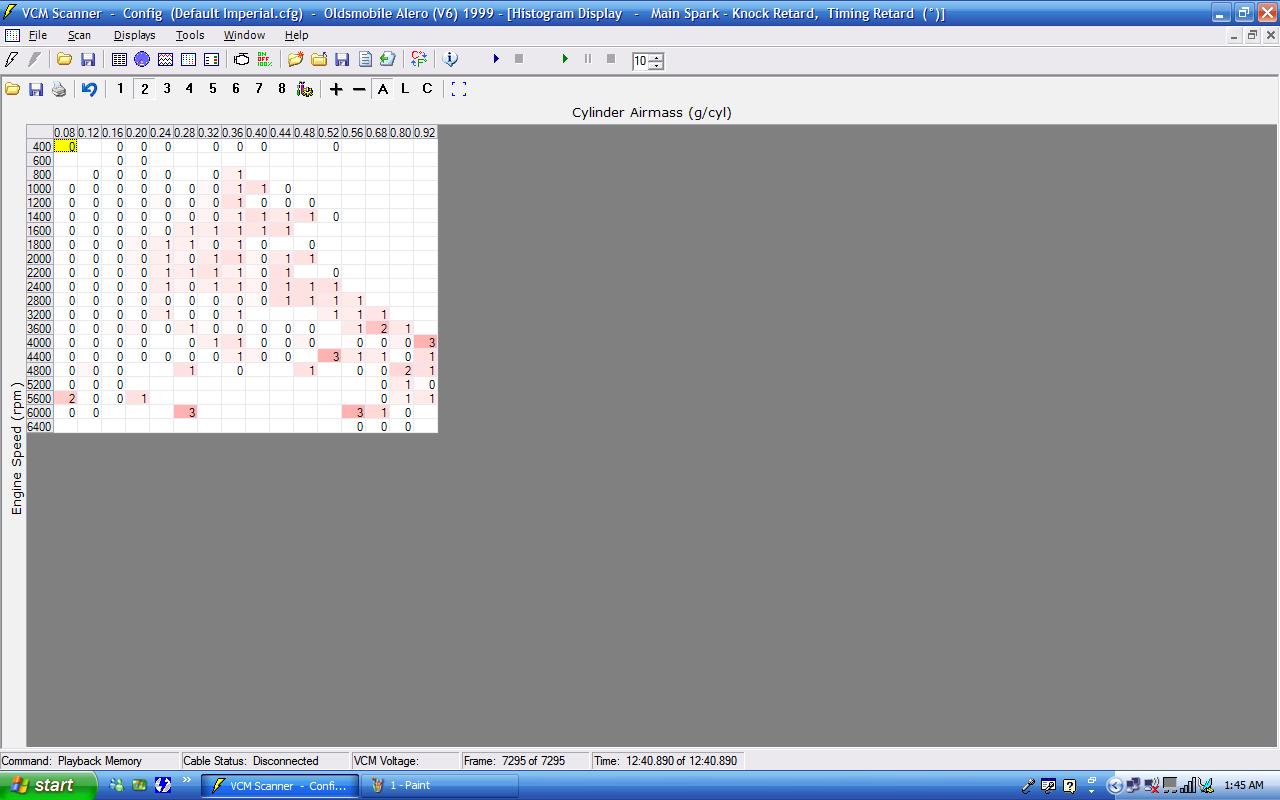

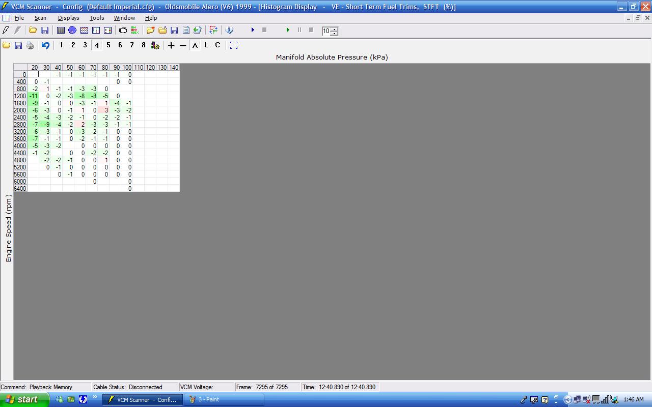

                        Mm can some one that has the HP tuner help me here's some pic's of the scans during drive
                          here's some read out's

                              It need alot of tunning because right now it's running lean, and some times it runs rich.
