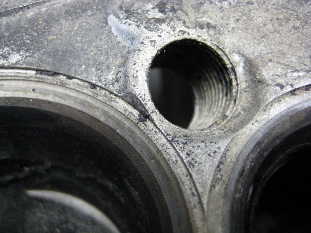

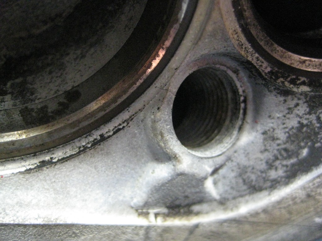

                          Just got these in the mail, both with cracks between the spark plug hole and intake valve seat. I can't tell you how many times I have had this happen so please look at your heads closely.
                            far too common with 3400 heads...
                            I haven't seen it myself but do the 3500 heads have this same issue?
                              I haven't seen any yet for the 3500 heads. Not sure if its metallurgy or design though.
