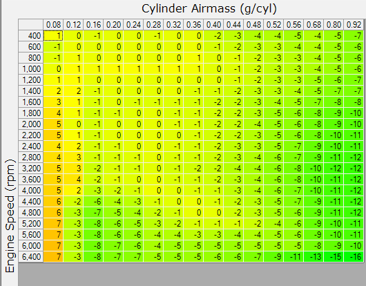

          Turbocharged 3100 5-speed at 8 psi. Used 97 Lumina stock figures for spark tuning.
          This table shows where I reduced spark from stock tables.
          Edit: Beyond 6000 RPM is reduced for safe over run.
