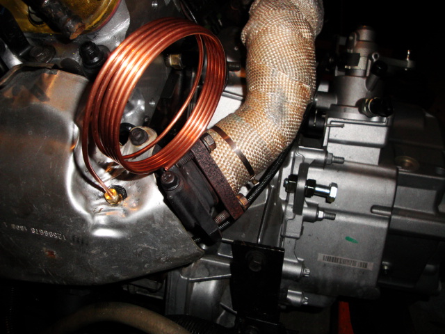

              Tech talk can become overwhelming and hard to follow in the absence of pictures. I'm working on getting some realtime results regarding efficiency as it relates to boost and back pressure right now. A simple tap into the exhaust to measure back pressure trends.
              The liquid to air intercooler will have to wait until funding arrives for it due to more pressing expenses that accompanied the reassembly of the forged motor. In the mean time I'll be collecting data to compare when it is installed.

                That is fantastic, awesome. I planned the same thing, but the mini-project is on hold for now. I even used a coil of brake line to prevent the sensor from heating up too much.
                I used steel line.

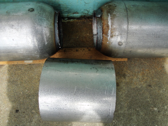

                  The car is limited to 3 psi of boost and so far under load exhaust back pressure is gradually maxing out at about 10 psi by 5000 rpm. That has more to do with the exhaust system than the turbo. I can blip the throttle for an immediate ~8psi pressure increase but it drops off to 0 with sustained rpm below 4000. I believe the brief increase is due to the time it takes the turbine wheel to spool up to exhaust flow speed and the actual pressure build up under load due to the exhaust system itself.
                  I have two turbo packs welded together, the 3" pipe out of the turbo joins in between them terminating into the 4" diameter short pipe that joins them. They have about a 2.25" inlet and are baffled although they look like common glasspacks. There are two 1.75" offset pipes internally and that is where the pressure build up is likely occuring. Unfortunately the 5" diameter case version still used 1.75" offset tubes instead of moving up to 2" internal tubes so I decided on the 4" case.
                  The car sounds great and the drone is gone which is what I was after from the start. I'll be adding a cutout at the center joint to allow open exhaust flow. The car is amazingly fast even as the rpm and back pressure starts to climb and I'm curious about whether the backpressure is responsible for the apparent city driving fuel economy improvement. It doesn't guzzle even when running it hard but I suspect that's a combination of the car feeling as fast as before on nearly half as much boost. Once it's turned up to 7 psi things may change.

                              I didn't note any vacuum (scavenge effect) on the gauge if any and doubt it is likely to occur as a result of the turbine because the blade design is not optimized for it considering the turbine blade arrangement is nearly the same as the compressor arrangement with the blades spinning in the opposite direction of what pulls air, except in the turbines arrangement the centrifugal movement of air may have an effect which would favor residual back pressure instead.
                              Whatever the case there is no sense in leaving the line in the car because first start moisture gets in it and stays unless you allow it to bleed out.
