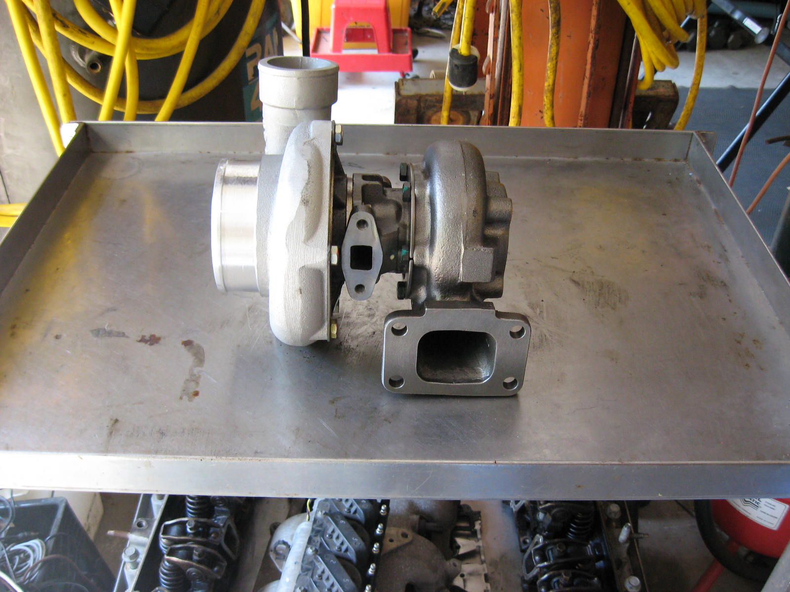

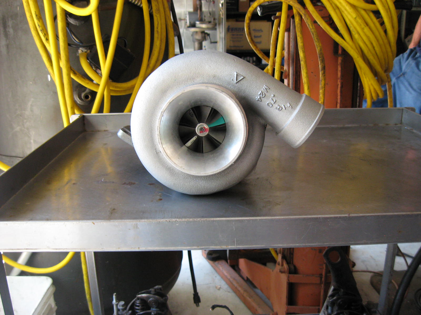

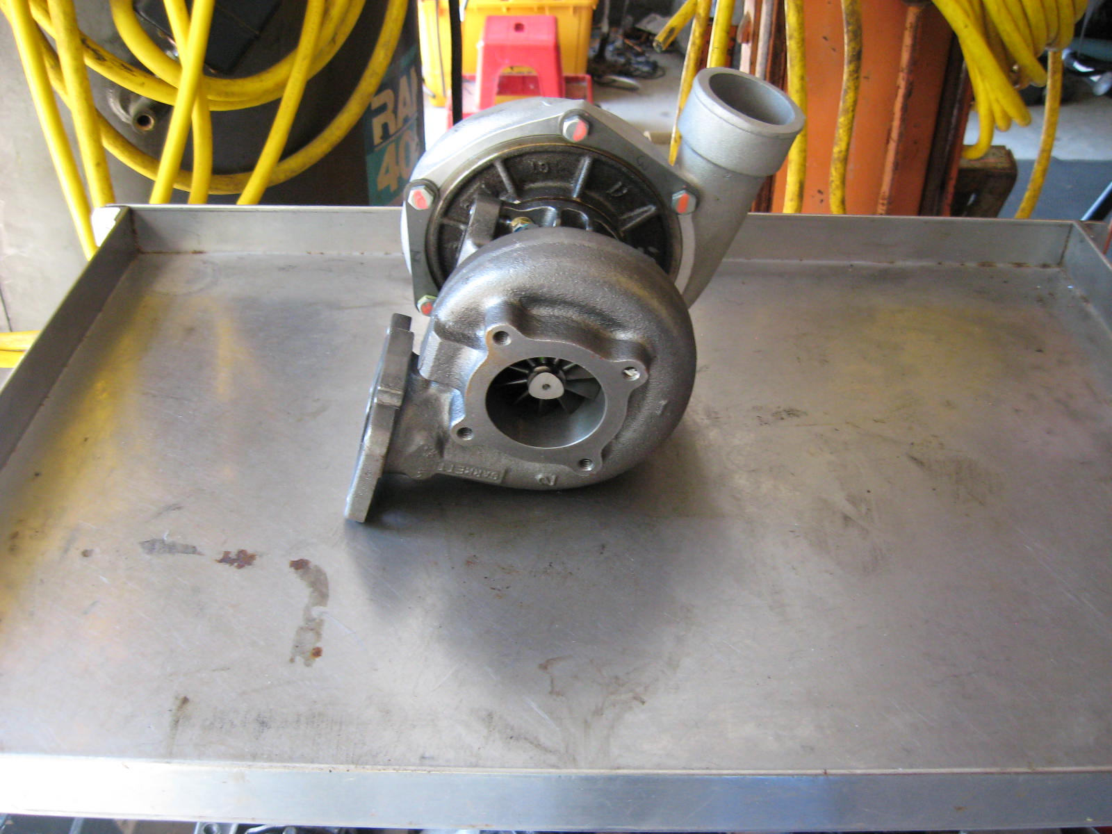

    I'm planning a 3.4/3400 project using an S10 platform.Wish I could devote all my time and money to it but like most I can't, so it's an on going process.Know you've seen it all before but I still like seeing what you guys are doing so thought I'd share. Garrett 60-1 60 trim / 70 ar stage 3 / .63

        Cool, had the same turbo last year on my 3400. Ran mid 12's in the 1/4 on 11 psi. .63 turbine is tight I found. .82 would be better suited I think, even for a truck build.
          Mid 12's / 11 lbs sounds good as I figuared 12-15 lbs for my build [ 9.5:1 using 3400 hypertecs in 3.4 block].Would a divided housing help if I move up to an .82 ?
            I don't even think you'll need the divided.
            You'll see the .63 will spool at half throttle going accross an intersection... (still very fun though) !!
              I'll keep my eyes open for an .82 housing.
