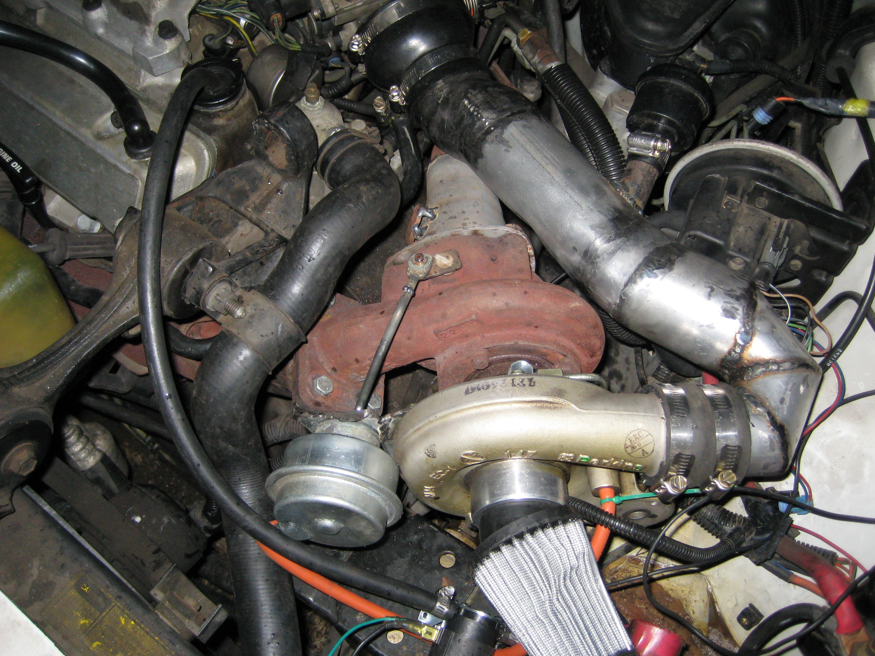

    Hello All , been trolling for a while . I picked up a garrett perkins diesel turbo off eBay for 100$ and built it into the crossover pipe on my 90 Lumina , Now this turbo came off a 3 cylinder. I figured why not run it the same way on my Car .
    so it now get's fed exhaust from the front 3 cylinders and boosts the whole engine. I definitely feel it in the seat of my pants and it works NICE ..Pics to follow (as soon as I'm able)

      Check it out... no Inter-cooler and I haven't put a boost gauge on it yet. it don't feel like any kind of HIGH boost , maybe just getting it to atmospheric ? the turbo gets fed from a sandwich adapter at the filter , and gets restricted at the turbo to .030 , scavenging is done by a El-cheapo eBay electric scavenge pump, Works Great. I've got another turbo that might fit the bill for going out back of the car ... Whatcha think ?
      I did NOTHING for tuning . No CE Light. & those spots are raindrops , Not OIL !

                    I checked it for boost and I'm seeing 2psi +or-.5 @ the regulator . I've disconnected the Gate as of now , I Popped the intake pipe and it's pushing a little oil. Whats your feelings about the red one I got ? its a t04. I was thinking of running it out back Ala' STS style ?

                        Sup Y'all , I've been running this setup for 1000 miles and it's great , No issues at all . PERIOD . thanks to everyone who posted up !
