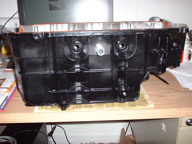

    Aluminum oil pans are easy. I tapped and died for a threaded nipple in the side of the pan and put RTV sealant on the threads screwed it in tight and called it a day.
      Teflon Paste works pretty good too
        Am I going overboard with this non-weld fitting?
        It seems like a nice tight seal, especially with Red-RTV on the outer side, leaving the inner side clean.
        I don't have a tap n die but I suppose I could use a -10 AN Male to 3/8" Male and get a bolt to thread the 3/8" male end, using RTV.
        What do you guys think? I mean, $40 is a bit much for fitting the oil return to the pan, but then again, not dripping oil is an honor for anyone building up their block.

          Tap as in drill bit and die from NAPA in the size you need and the threaded nipple of choice from Advance or Autozone autoparts should do it. The potential problem with the item you are looking at is that you will be limited regarding where you can place it because of the ribbing on the oil pan, if it is more than 1.25" square. If it fits in the designated location that's fine. I don't have the oil drip issues you speak of. A good job on install with proper sealing techniques should eliminate that, even if it takes making a washer for the nipple and putting a rubber o-ring underneath before screwing it down.

              I agree with Joseph, the oil pan is thick enough to thread, much easier and probably cheaper. If it were a steel punched pan, I would recommend something similar to what you showed (but again more simple) - we use a double sided 10an male/male fitting with a large fender washer and nut.
                Cool deal, that is how I will proceed with the oil pan tap. -10 AN Male/Male with a nut, washer and rubber o-ring fit to size.
                Seems simple, effective and most importantly...CHEAP!
                Reason I was hoping for a steel pan is I can weld steel easily. Aluminum is out of my equipment range. But, problem solved any how.
                  I was saying if you had a steel pan do that, the aluminum one is thick enough to thread.
                    Ohh, I had to re-read what you said and I see what you meant.
                    Weld or AN male with nut/o-ring if steel but thread if aluminum.
                    Again, thanks for the info.
