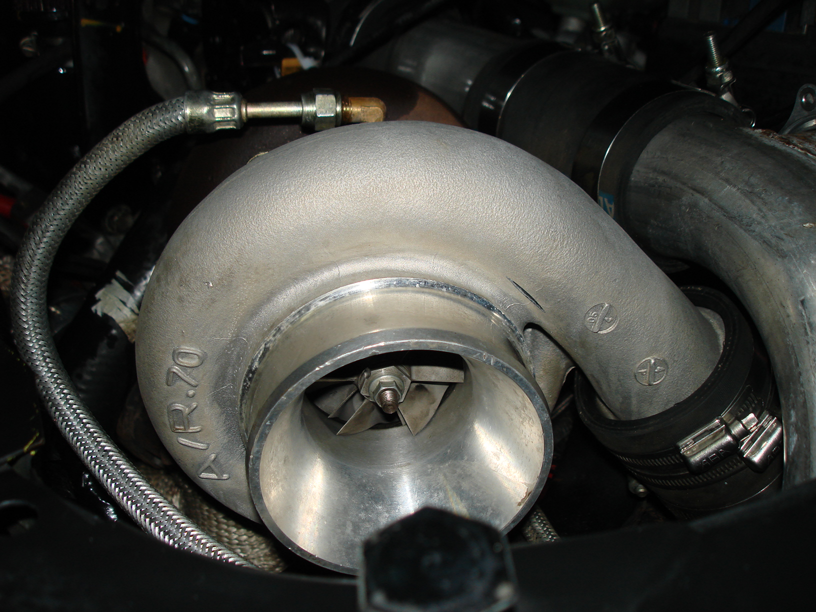

          here's the feed line
            Doesn't appear the lines are the problem. That looks like a -4an fitting, and that's what most turbos recommend.
              Well the problem is solved now, I just put a restricter on the feed line and now its ok.
              Thanks for youre help guys
