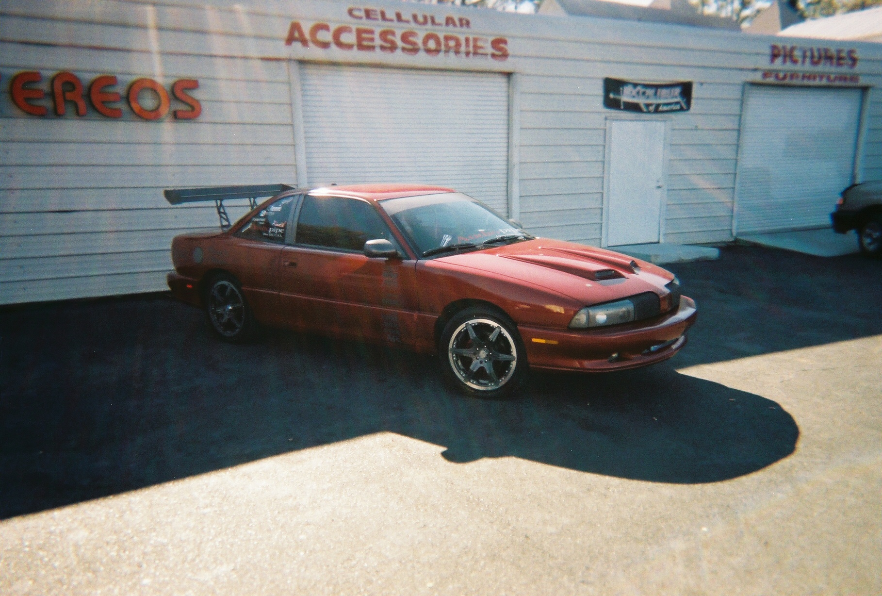

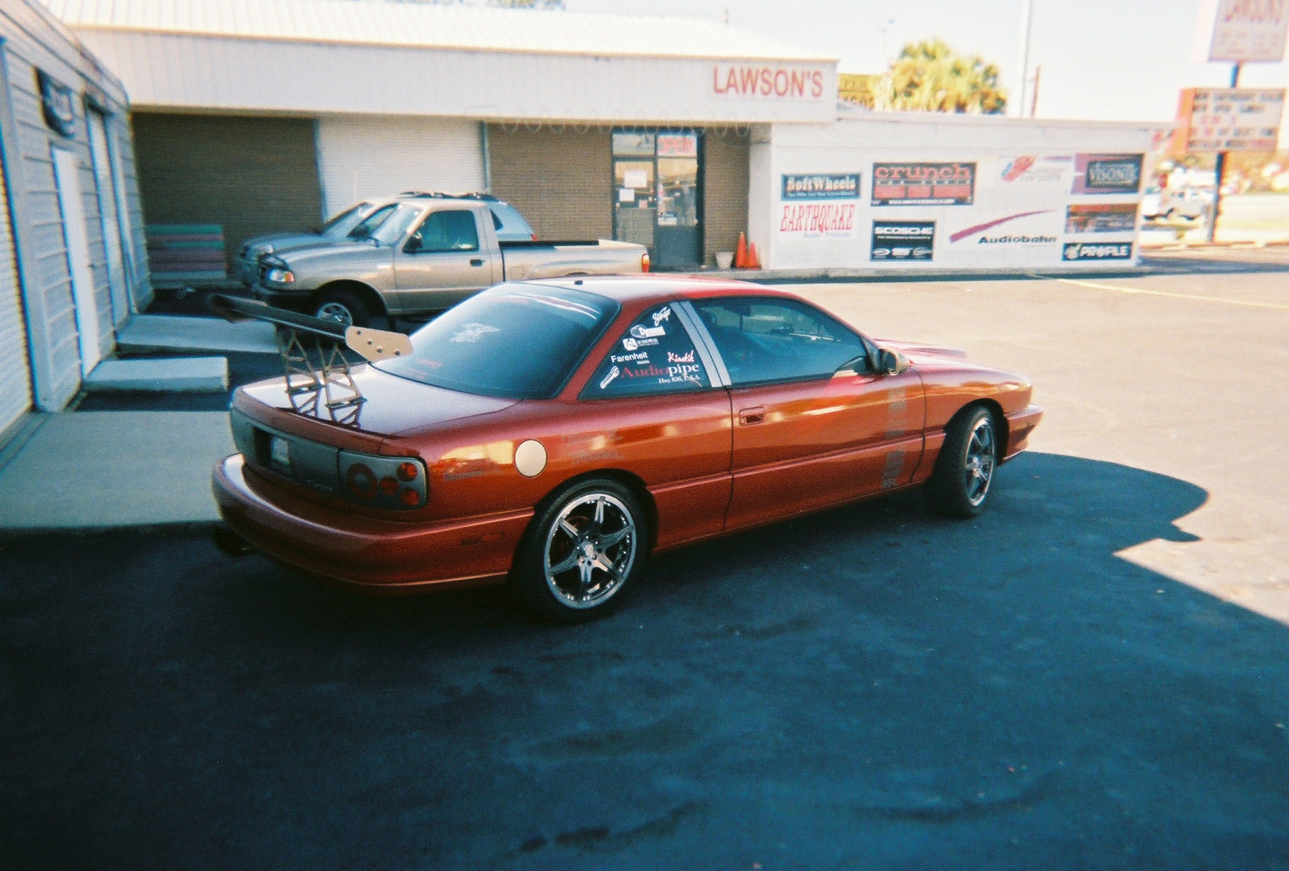

    well by now i got all the info i need concerning boost, and thx alot to all that have chipped in their knowledge.. i'm lookin for sum nice heads and ported and polished intakes upper and lower, once i get these then i'll boost it and my ride will be ready....???? where and what r the specifics about the walbro 255l fuel pump thought about adding a electric fuel and keeping stock or should i change the stock alone...let me know fellas , when i get done my ';94 acheiva will be a terror in these parts..thx. u can check the car out on cardomain.com under domestic x. tuner...
