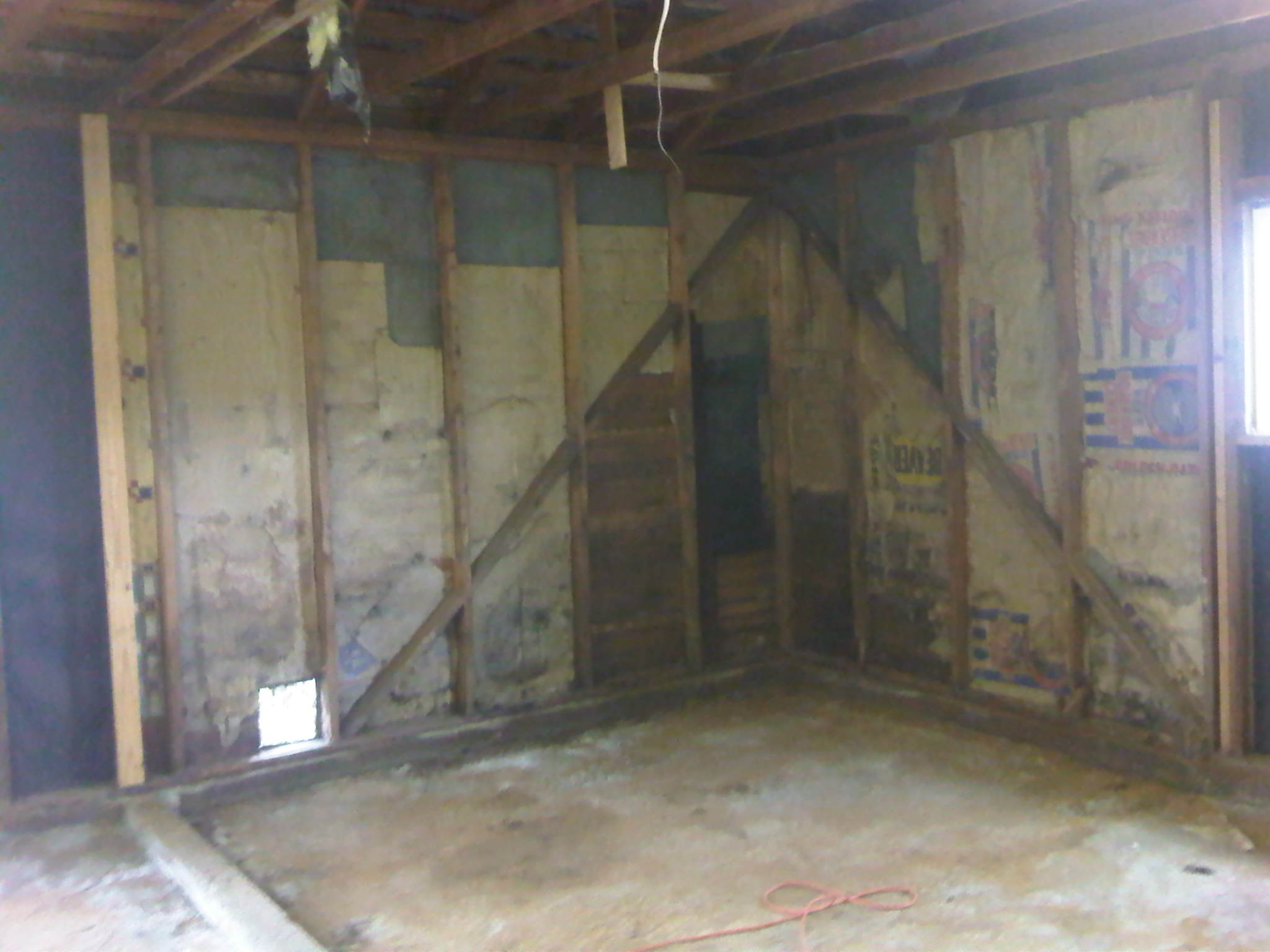

    My car projects have been stalled for a while, but I'm itching to get wrenching again. I bought a little house last spring with a kind of rough 20x24 shop, so I'm fixing it up to finally have a decent heated space. The structure is nearly as old as the house we figured from stuff we found in the walls, somewhere around 70 years old. The concrete was cracked and heaved terribly, and there was an old cold room inside. First the cold room came out. It was insulated with sawdust - what a mess...

    The moisture that was trapped in the sawdust did rot out the framing in that corner, the bottom 3rd of those 2x4s just turned to powder. Luckily the siding is some beefy 3/4" T&G or shiplap and it was carrying that corner.

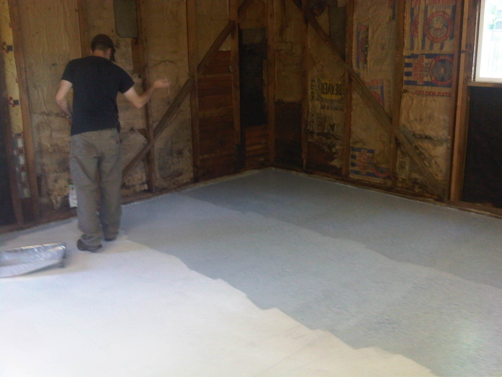

    A new floor was a must, I hired that out, I wanted it done right. Tore out the old floor and had a new slab put in. Let it cure completely, then we epoxied it.

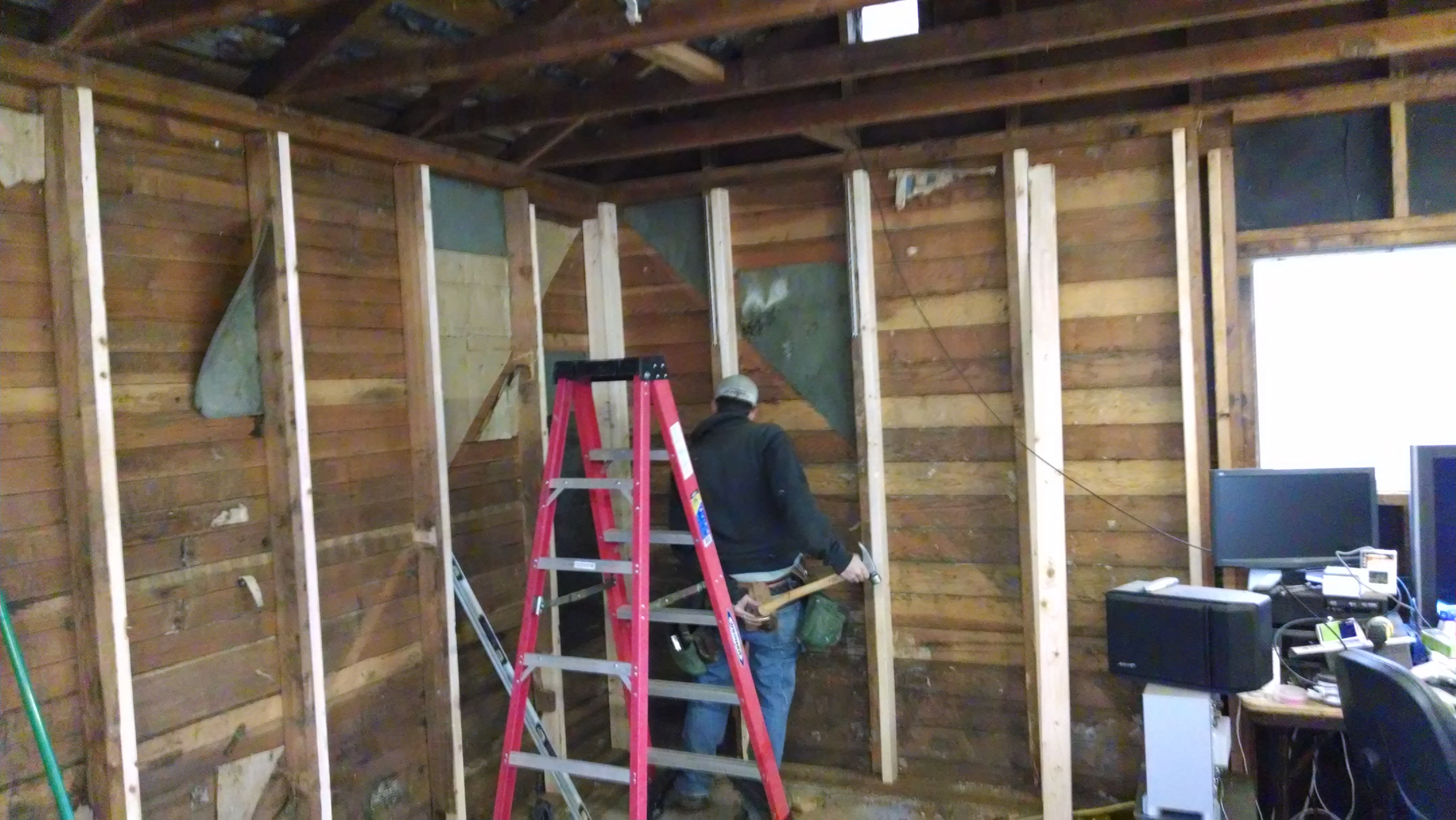

    My friend and wrenching buddy is an ex-carpenter, so he helped me sturdy things up with a new PT sill and fresh studs. It's solid now!

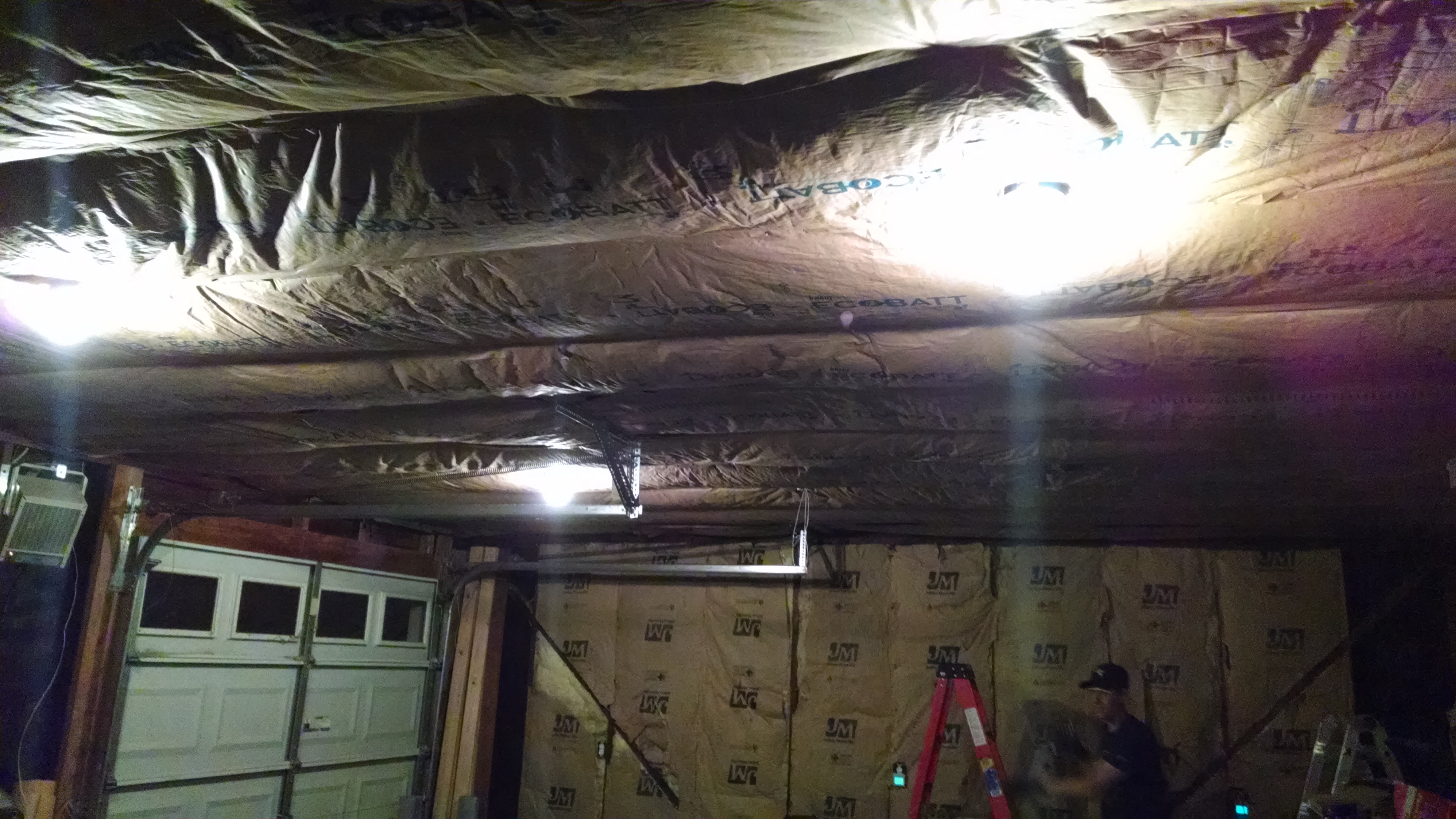

    Finally did all the other prep work and I've started to insulate. R19 in the ceiling - the way the place was built I didn't see much sense in going higher than that. It'll make a world of difference. The PO had leftover R-15 from the house that I was about to do about 1/4rd of the walls with. I'll get some R13 to finish the rest this week. I'll probably have a sheetrocker friend come in and do his magic in the next week or two.

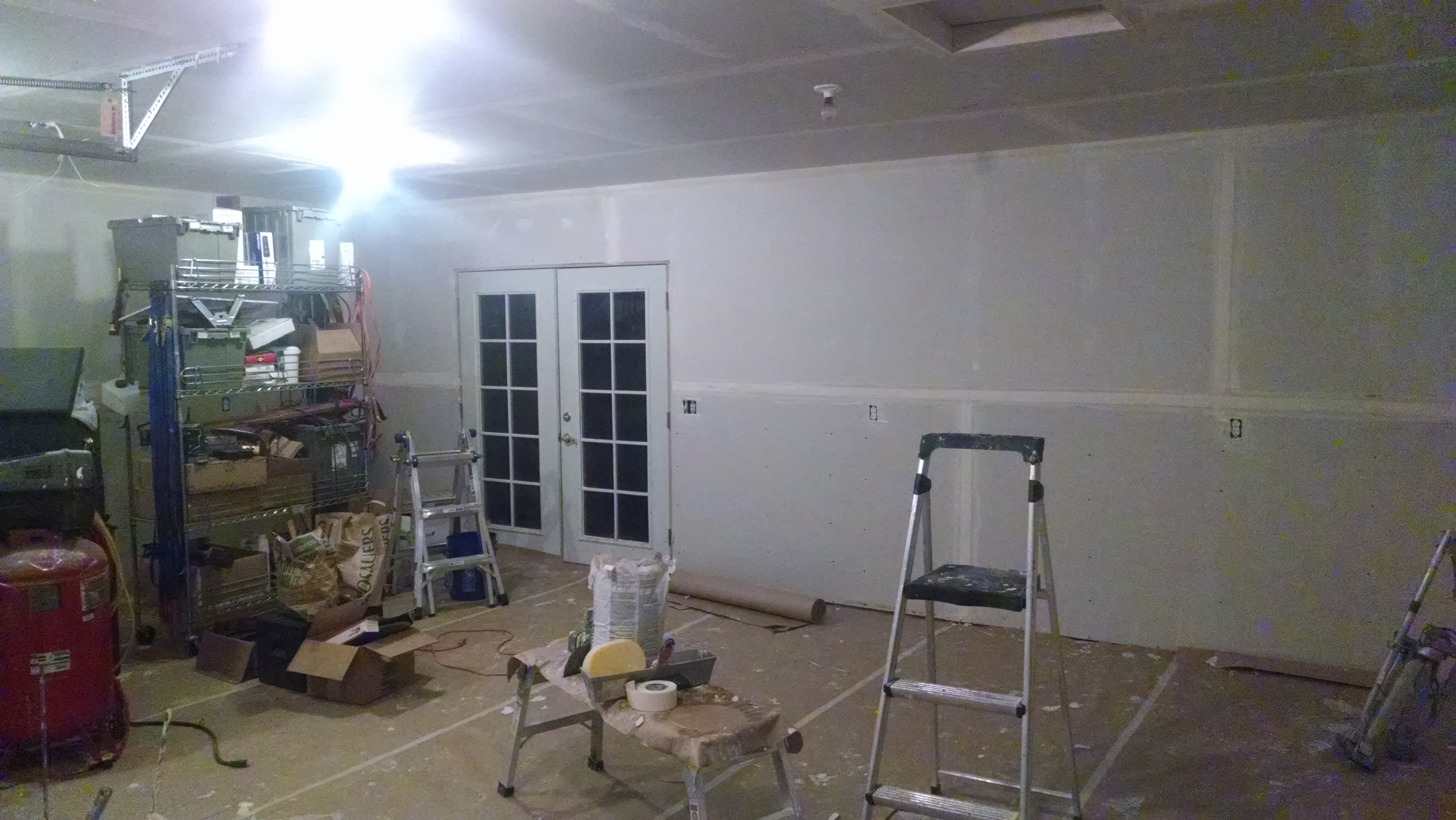

    Sheetrock will be done early this week, maybe I'll spend my day off Wednesday painting it.
