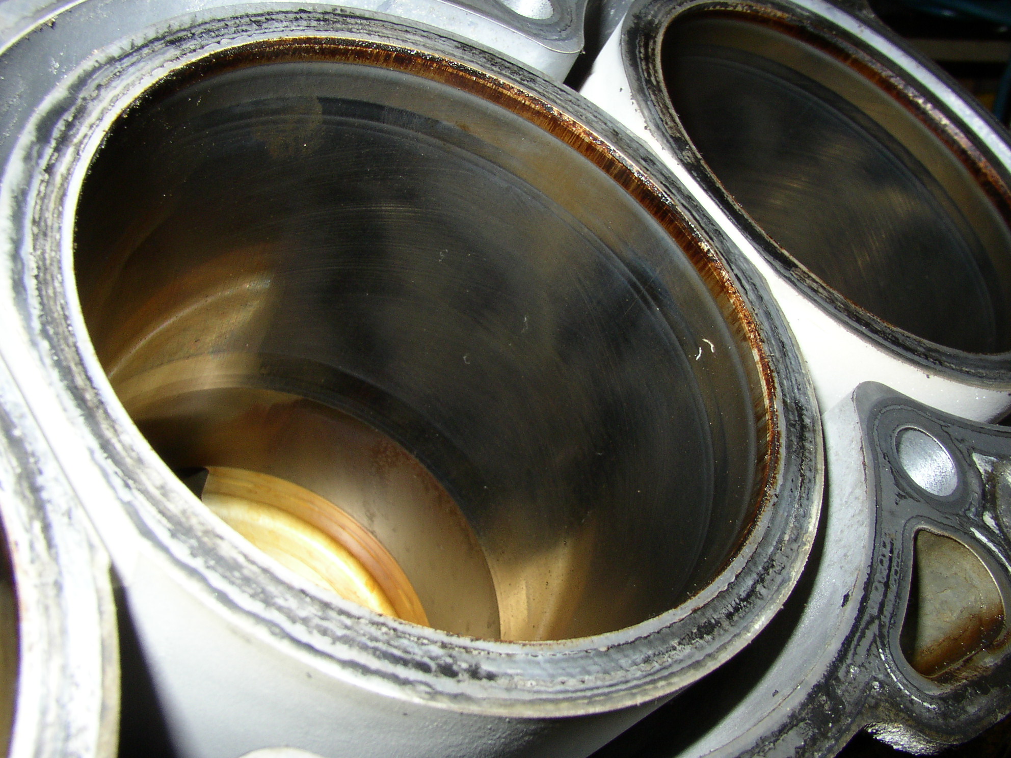

Aluminum block.
I pulled the block with the crank and flywheel off of my stand and those pieces weighed less than 40lbs if I had to estimate. Needless to say, this is the main thing I'm after in this engine- the aluminum for scrap.

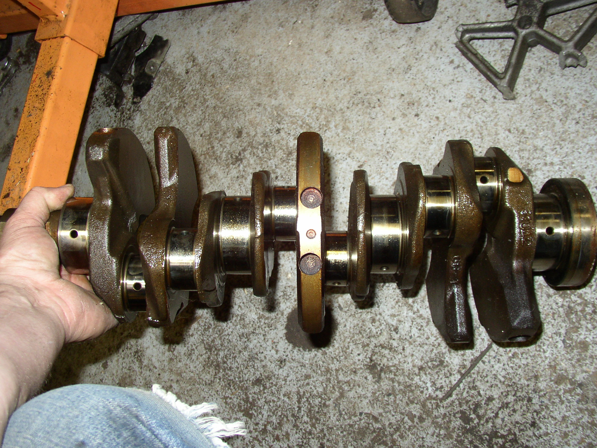

Crankshaft.
From the machining marks I've seen on the 3500 forged crank at Ben's house, this crank appears to be forged steel. I also noticed it looks like they machined the oil feeds all the way through the side of the counter weights and then it looks like they've pressed a steel ball through the hole to plug the end to avoid a huge oil leak internally. The crank does have small journals for my taste though.

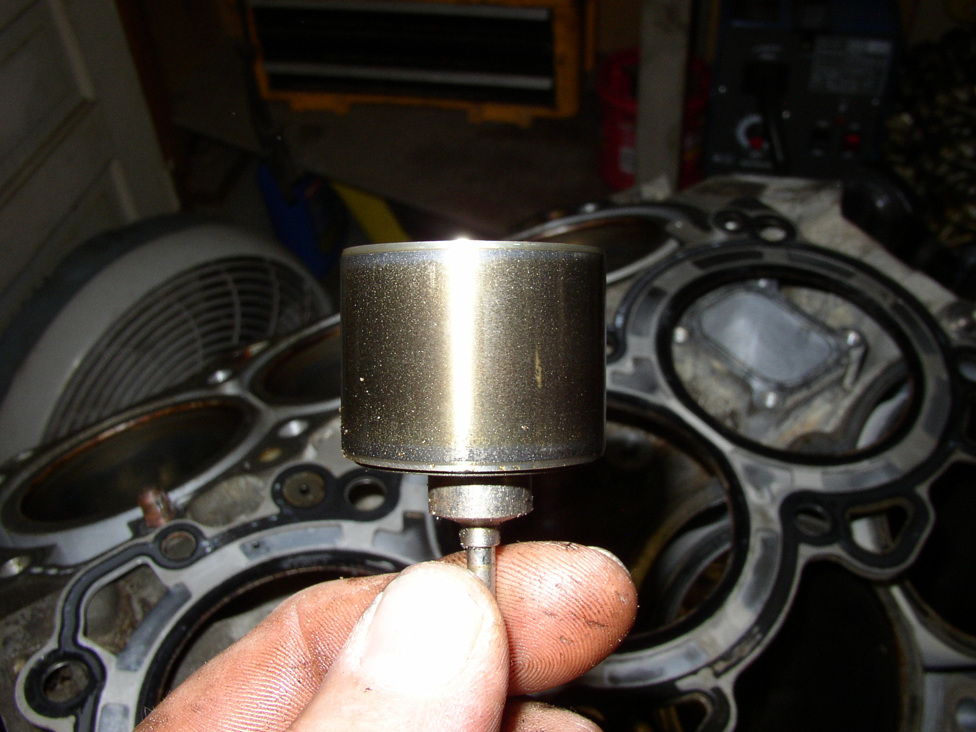

DOHC Bucket style lifters.
The lifter skirts are longer than the skirts on our DOHC lifters. They also have a small button in the center on the bottom, but the really neat thing is the pad that the cam rides on... The pad has a strange hole in it (I'm assuming to feed the cam lobe oil in operation), and the pads actually rotate independently of the lifter itself. You could actually rotate the lifter itself clockwise and the pad counter clockwise at the same time.

Aluminum block.
Crankshaft.

Head gaskets.
MLS, from the factory with oil restrictors in place on the oil passages. It's also an open deck with siamesed cylinder configuration.
