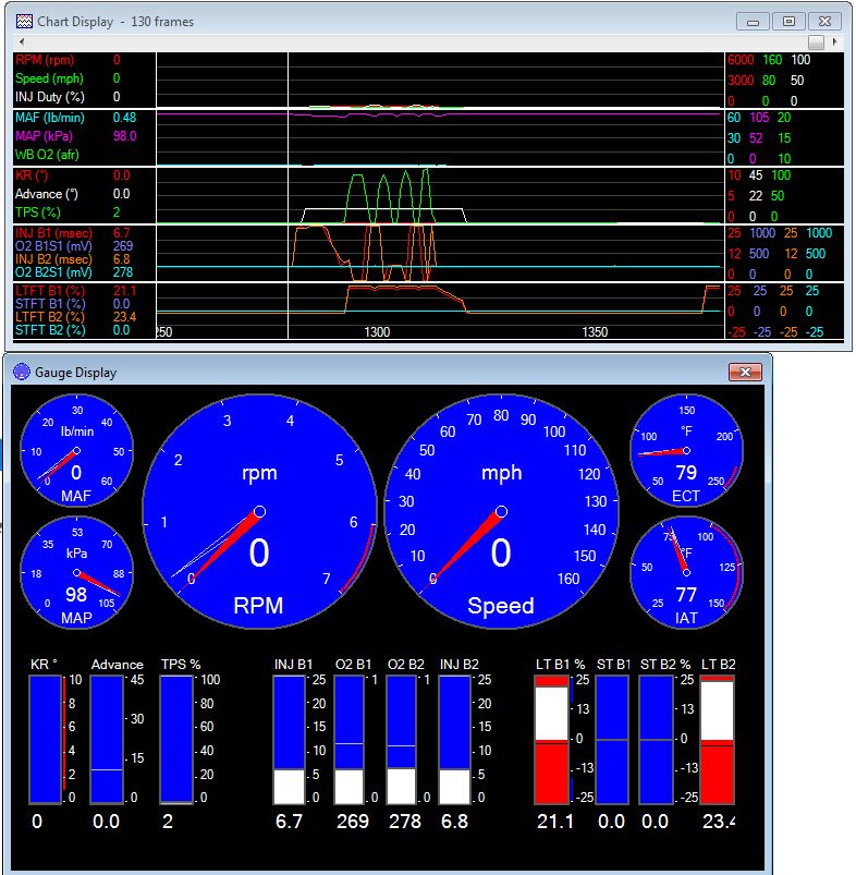

    Attached is a screen from HP tuner scanner. Might be some useful info for someone. No DTC's. It just cranks, fires a little, when it does run it blows some nasty smelling blue-ish smoke. It won't start and stay started any more. Doesn't matter how well the plugs are cleaned up. They get nasty too. If we remove the plugs and crank it, it takes about 5 or so revolutions before all the fluids are pushed from the cylinder.

      was the engine running at all during in that graph?
        No it wasn't running. I tried saving the data but it kept crashing so I lost that. It ran decent yesterday. About 35 miles. Ironically without a O2 sensor. The stupid thing stripped so we had to tap it. There was a DTC, P0137 HO2S circuit low. I don't think it was bad but we took it to a shop that hooked it up to a super-bad ass scanning tool that didn't say anything we didn't know. He said, change the O2. It was also missing on cylinder 4 and 5. There was some DTC's about random misfiring but that never happened after the exhaust blew some large orange sparks. They were burning on the road. However, it started running much better after that. Annoying trying to troubleshoot a issue. The coil packs are expensive for that truck.
