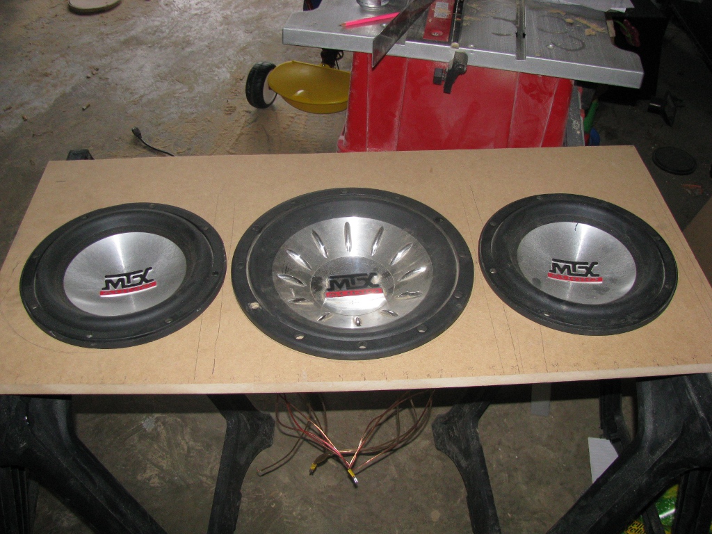

What I'm looking to build is a triple sub box (I have 2 10" MTX DVC and 1 12" MTX DVC). A bit
overkill but they sound nice anyway. And at moderate volumes they don't rattle everything a part.
The 10" provide responsive bass while the 12" just sound awesome in a vented enclosure.

Each box will be a separate enclosure.
10 Box volume: 1.45ft ea
Vent: 19in 12/16 x 2in
12 Box Volume: 2ft
Vent: 16in x 2in
