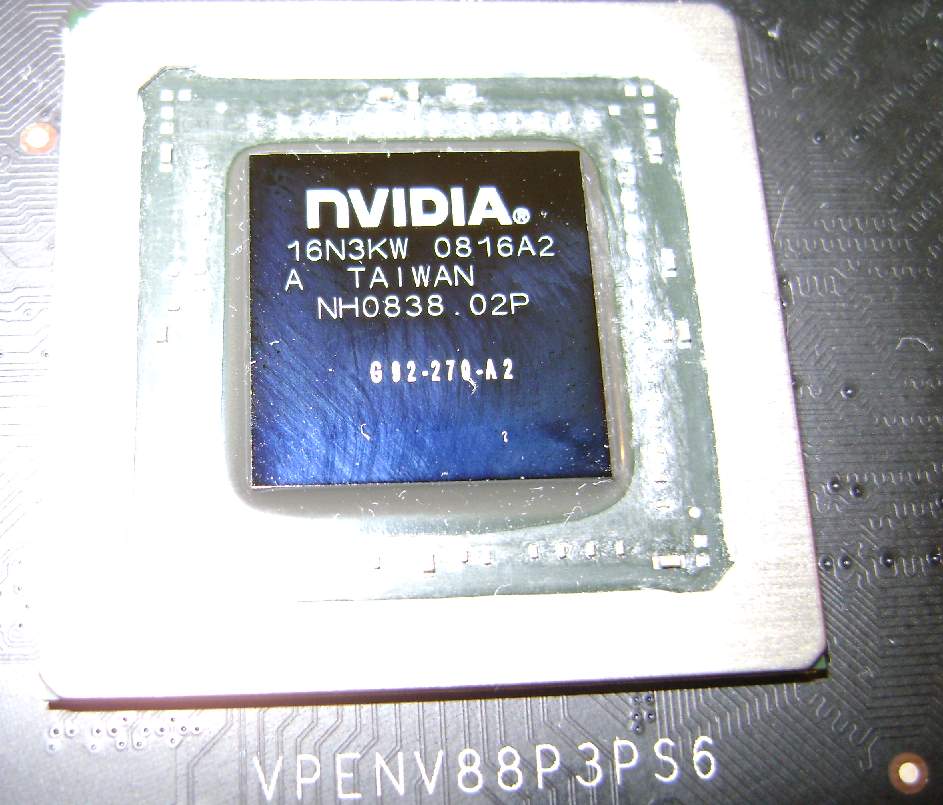

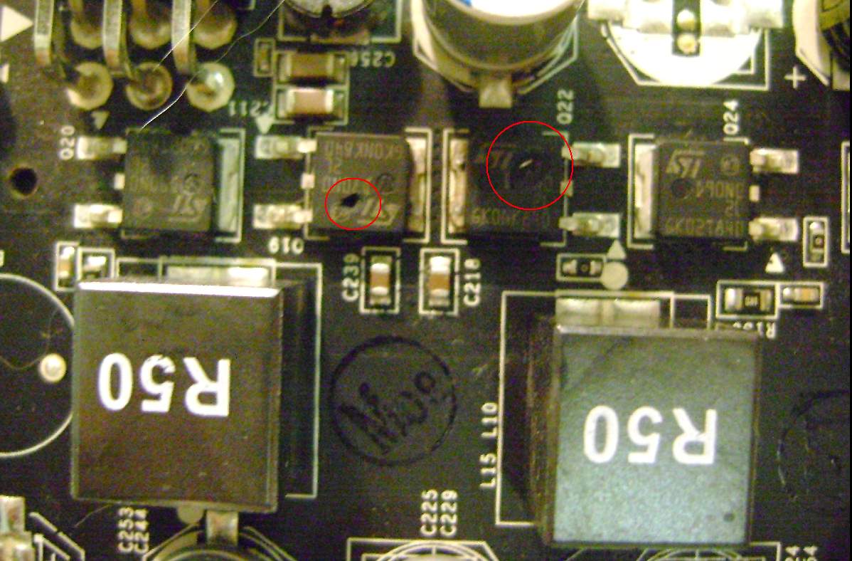

    When I had the time and few minutes to spare, I looked over the XFX 9800 GT card and decided to disassemble the copper cooling block via the four, spring loaded chrome screws on the back plane of it and it looked like the GPU showed no signs of burning, discoloration or over-heating. This prompted a closer inspection of the rest of the board with a huge scientific magnifying glass...and I spied what looked like two resistors (I'm guessing here...) that, to quote Dallas when he looked at the chest of the Sky-Jockey in the derelict Alien Space Craft on LV-426 in the movie "Alien"... "It Looks like he exploded...from the inside...."
    I glommed a few snaps of the GPU (which looks suspiciously like an 8800 GT...if you ask me...) and the damaged resistors to get some opinions as to whether I will be able to "un-brick" this XFX Card... I copped the numbers off the busted components and searched for them on the Net...but no luck... besides that... I cannot tell if the two Effed Up parts are wave soldered in, making a Gerry-Rig repair by me next to impossible (looks like little silver waffles on the back side where the numerous pins poke through the board and have tiny drops of solder holding them in place.)

      i'm no electronics expert, but those kind of look like transistors...

          Despite having 4 years of electronics in high school and repairing TV's and VCR's for a while I'm no pro, but I agree. That or some sort of regulators or rectifiers. I would lean towards regulators or transistors though.

              That's an odd feature. It must be part of 7. At least those SMD's that are broke are a lot easier to desolder with wick and resolder than an SMD resistor.

                      Ahhhh.... Now THAT one makes sense... Got any ideas on how I can get a few of whatever the ones are on this XFX card (see images) I'm curious to try and unsolder them and try to dummy up two new ones and see if the card can be "FEEN-ixed"... as in Phoenix...Rising from the Ashes... kind of fixed..

                            Maybe another dead card from ebay? Go to Radio Smack and pick up a roll of solder wick (they might also call it solder or desoldering braid). It looks kind of like the old style braided ground straps, but it's copper and much smaller. You heat it up between the part and your soldering iron and it sucks the molten solder right up because of the way solder moves.
