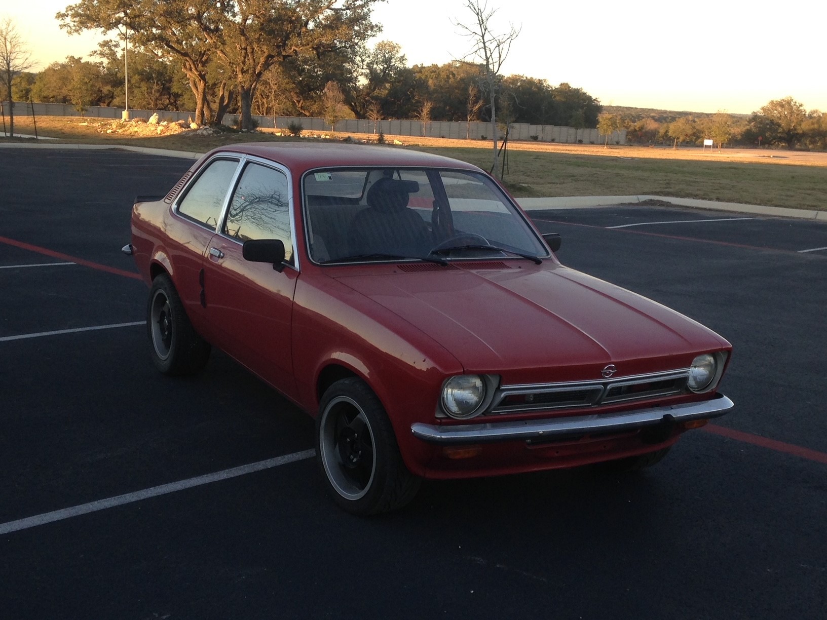

    10 years ago, I brought an Opel Kadett back from Europe with intent to swap out the drivetrain for a little more go. Over the next few years, I swapped in a 3100 V6 (converted to RWD) and T5 transmission. The stock 3100 is from a 99 Grand Am with a OBD1 7727 computer from a 92 (or so) Lumina. My plan was to use this engine to get it put together but planning to build and swap in a better performing engine at a later time. I've been driving the car off and on over the last 10 years and am now ready to swap in a different engine. I'm looking at a wrecked but running 07 Impala with an LZ9 3900. The 3100 I have now has been converted to rwd by rotating the upper & lower intake 180 degrees, swapping the timing cover to the rwd setup and custom headers. The oil pan has also been sectioned for crossmember clearance. I don't need too much from the engine so will sacrifice some performance to keep it simple. I'll be searching and posting in the engine swap forums to get ideas and figure out how to actually make it work.
    You will probably have to modify the engine mounts, and deal with the crank trigger or use a different computer. I swapped to a 3400 crank and custom pistons/forged rods for my future OBD1 engine swap, but I wanted simplicity and another comparison for the rod lengths in similar builds. Dan swapped an LZ4 into a FWD race car, so I know how that can be done but I don't think you need to deal with some of the things a FWD swap not using the VVT cover would. Not having coolant running through the intake might make a custom lower intake easier in the future as well. Post some pics of the car if you can. I looked some up on google, reminds me of a few different cars but not the Opel GT like I thought of when I was you had and Opel
      I wasn't sure about the engine mount differences between the 3100 and later blocks but my engine mounts are fabricated based on the various mounting holes cast in the block so making new mounts to fit the 3900 block isn't a problem. I've done some reading on the crank trigger and VVT issues and was thinking I could mount an external crank trigger to solve that issue and for the VVT, I was planning to lock the cam (not sure how/what degree is optimal) and remove the VVT mechanism to allow the swap the RWD timing cover. If possible, I'd like to use a 3400 or maybe 3500 (for better flow) lower and upper intake on the 3900 if that doesn't require extensive mods to do so. I like how the 3100 fits in the car so would like to keep external dimensions (timing cover/upper/lower intake) as close to the current 3100 as possible. Do you know if the 3100 and 3900 oilpans are the same? Click image for larger version

        That's a pretty nice size engine bay The oil pan is different, and holds less oil as well. I had spacers made to use the older style cam, but I also wanted a bigger cam. You can't use the older manifolds on the heads either. Its also going to need an adapter for a cable driven throttle body. The coolant will have to be routed from head to head above the timing cover. Im not sure if the stock crossover works with the RWD cover, or if you would have room to run coolant between the heads and the firewall/trans side.
