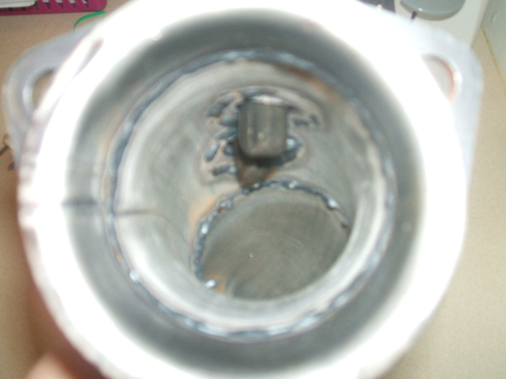

    Just tested the DP and it is air tight. Got the bungs welded in and it fits like....perfect. Though I still need to smooth the weld beads inside the pipe. But at least it shows fantastic penetration for a tight seal. Tig is beautiful when all impurities are removed, I spent time prepping the surfaces and it paid off for this noob...lol
ID:	380990Click image for larger version
ID:	380991Click image for larger version
    Has 2 O2 ports and an EGT port near the turbine. V-Band flange for the turbine connection.

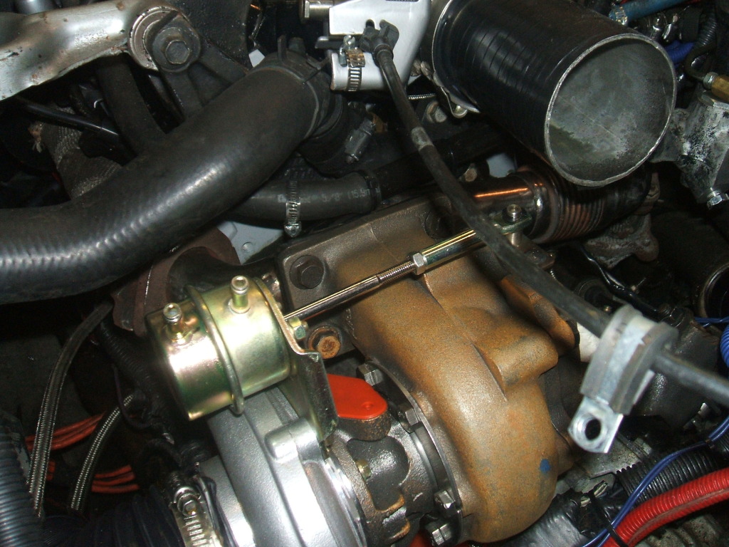

    Here is the turbo bolted to the crossover. I'll get more pics when I pull it out for exhaust wrapping.

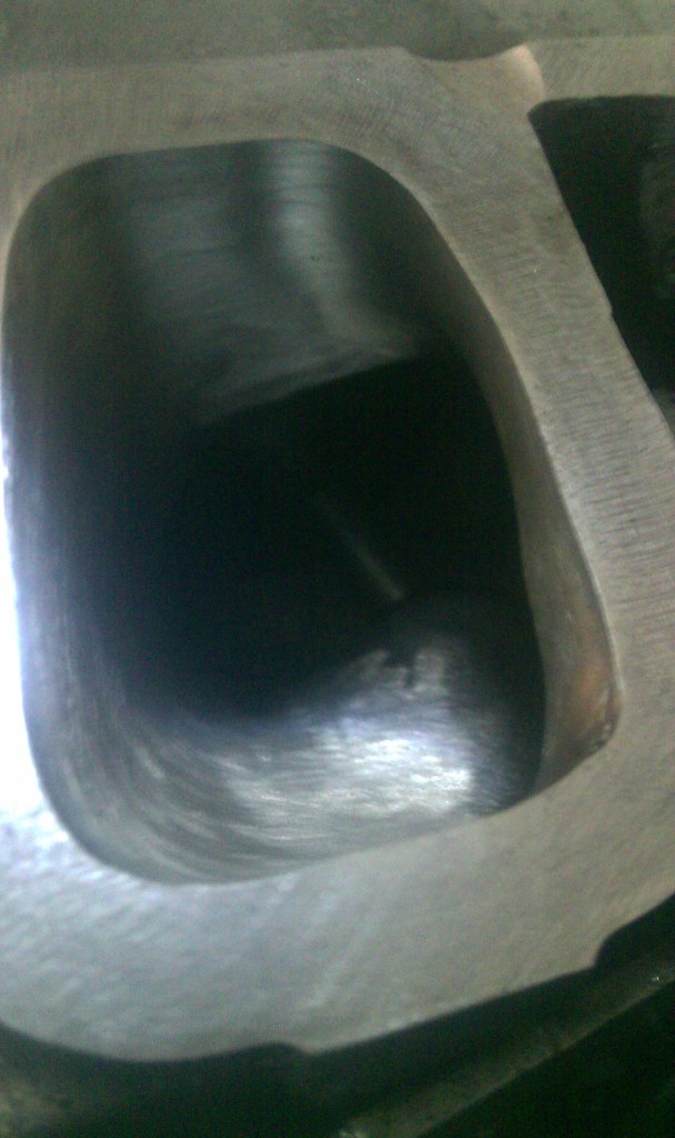

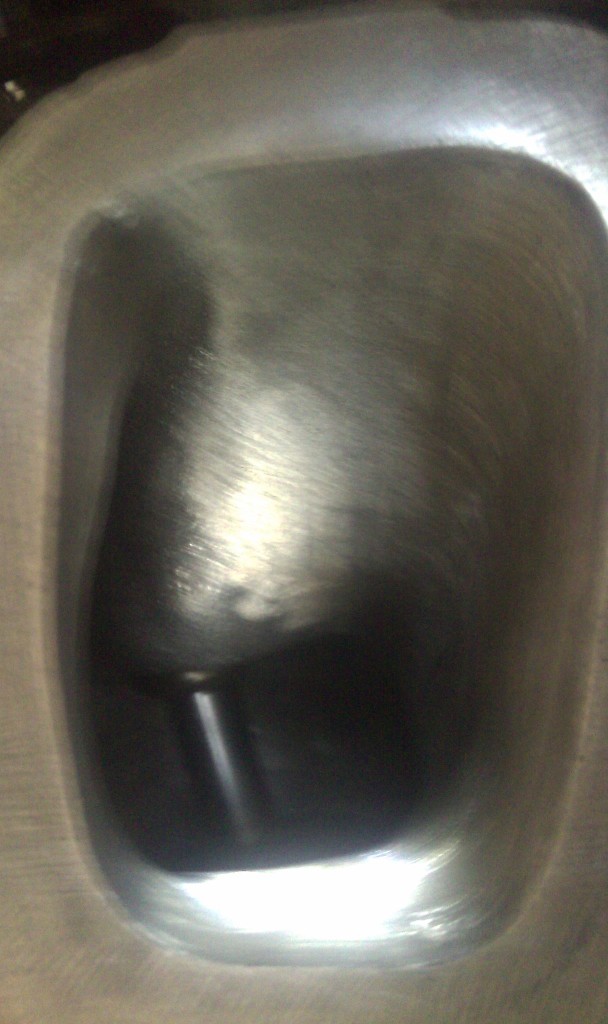

    And two pics I found of the heads port work. Just mild smoothing with a texture.
ID:	380994Click image for larger version
    For you first try at tig welding that doesnt look bad at all Adam
      Thanks, what really made it was cleaning the steel down well. Being a painter for many years I can appreciate the need for a good prep.
      I have the steady hand....unless I drink too much coffee.
        I agree on surface prep. I got my crash course doing exhaust work on my truck. 200k+ mile rusty pipe is not easy to weld to unless cleaned properly. After I found that out, that Harbor Freight flux core doesn't do a bad job for what it is. I even got some fresh nickel look to some of it.
          Yes, fcaw can be effective with exhaust pipe. The turbo flanged/crossover however, ugh a fcaw just made a mess. Trying to weld an 11ga steel pipe to a 3/8" steel flange was not happening. Too hard to heat up the flange well enough w/o burning a hole in the pipe.
          But wow, tig was soo much better then I thought.
