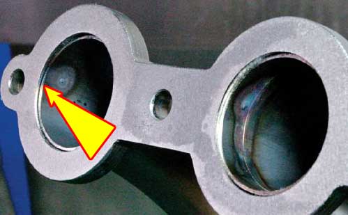

        • Originally posted by Superdave View Post
          there was a lip where the primary tube sat inside the flange and some of them were pretty ugly . The transitions are now extremely smooth.
          I hope you aren't talking about what I think you are, because if you are, you just removed your anti-reversion lip..

            Not on the head, on the header. Pic borrowed from another site but you can see where the primary tube lip sits inside the flange. After using the D shaping tool the pipe didn't sit completely flush with the flange all the way around (worst at the corners of the D). Mine are only welded on the outside edge so smoothing out that lip is no problem.
              On our headers, I weld the outside of the primary to the flange, then use a round ended punch to get them perfect, I like doing that vs grinding out material.

                    I tack them, peen them, then weld the outside fully while having the flange bolted down. As long as it completely cools while bolted, they are flat - even if they warp a little we resurface them on a large belt sanding table. Welding the inside presents issues. If TIG then the flange gets melted away a bit and may not seal at the gasket, or if adding extra material they need to be machined. MIG will build up a lot of material, and have to be machined and maybe even ported some to get them smooth. Also, when welding the insides, there is nothing to keep the flanges from warping, and trust me, they warp a LOT.
                    Here's a pic of the hand peen on the primaries, even after using Marc's press-tool the bends don't always go nicely (specially the tighter radii). The primary on the left has only been pressed, the other two got a peen and are ready for final welding.

                      • Exactly what i was talking about although none of mine were as bad as the one on the left.
                        I did actually MIG weld the inside of 2 of the primaries, as John said it left a lot of material and i ended up grinding them out a few years ago. The others just bothered me and i decided to fix them while i had them off.
