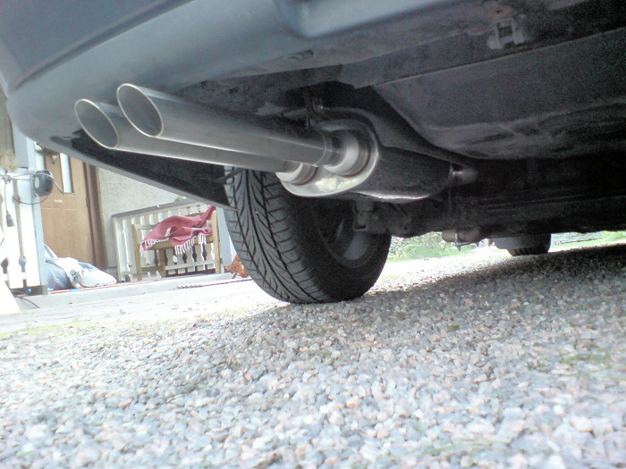

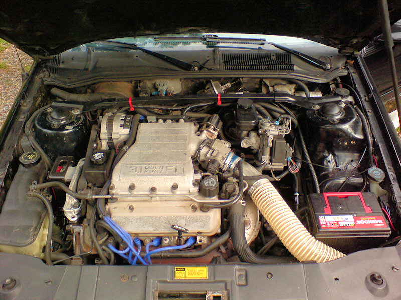

    I dropped it down with Sprint Springs and Added Koni's adjustable struts, put on Magnaflow muffler to it with stock look tips, and added a ghettorigged CAI, FFP dogbone, and bad fitting poly-insert. Also got the WOT-tech chip. And some exterior details bla bla bla...

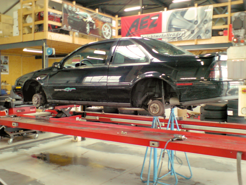

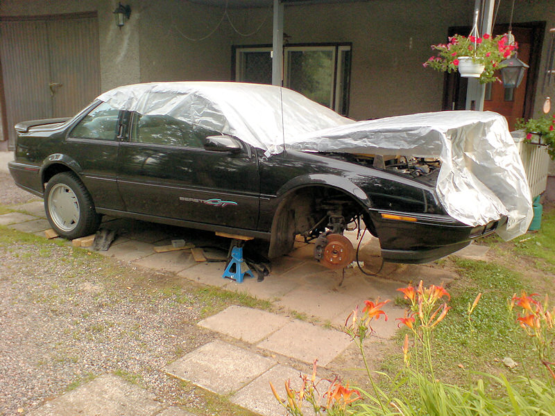

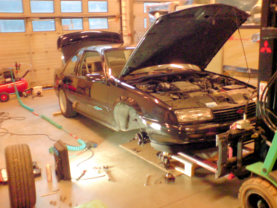

                I spend lot of time fixing the rust issue from the firewall, and also swapped in manual trans finally.. also did polys and Addco rear swaybar, new control arms and stuff, removed AC bla bla.

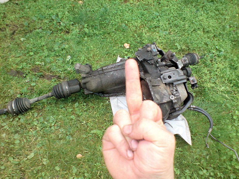

                Bye bye, not going to miss you.
                Working outside @ rain sucks.

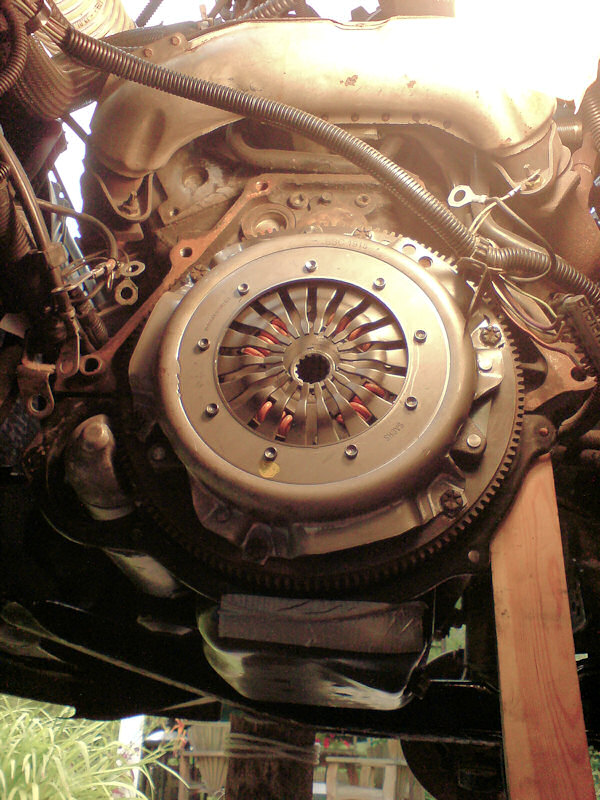

                Ordered AC-delco clutch and received Sachs.

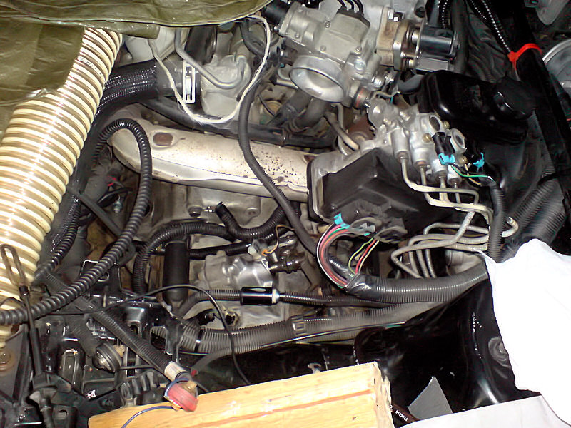

                Isuzu 5spd in

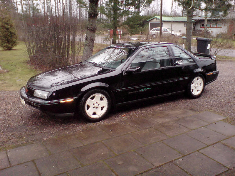

                Currently rocking on winter tires. Some thousand miles done with the manual swap now.
                My experiences with the 3.1+ Isuzu combo are:
                - First gear is useless in wetsnow or any else slippery condition, i can daily drive 2-4-5th gear just fine.
                - Full throttle at first gear is useless, only means wheel spin, and the gear is too short, i can only get like car length before shifting to second, this thing should rev higher.. i need to turn low end torq to high end hp..
                - Clutch is holding just fine, i can feel no slipping yet
                - Transmission is holding just fine, except that if i pull the shifter to 4th gear when over 5k RPM, i can hear bit sound, even if i have the clutch floored... worn shift cable maybe?
                - Engine braking easily gets the whole car rock forward and back, when in 1500-1000rpm area, my guess is that transmission side mounts are too weak. Maybe i need one of those engine shocks that people use on Japanese cars.
                - Exhaust pipe has moved back with the engine and now makes noice by hitting the body on bumbs.
                Also got the car scaled from every tire, the weight disribution was near 61/39%, total weight was 1360kg (2998 lbs)
                If i take 40L of gas and 30Kg of subwoofer weight away, car should now weight around 1280Kg (2821 lbs).
                Next things this car will receive is Magnaflow free-flow cat, and the new engine i'm putting together when i have time for it.
