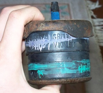

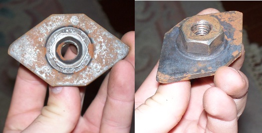

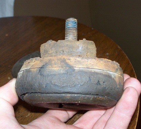

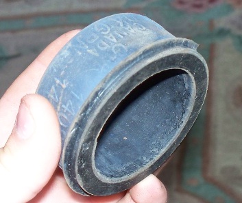

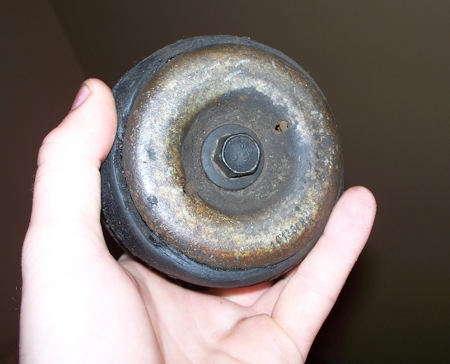

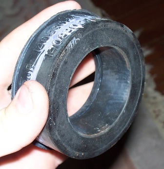

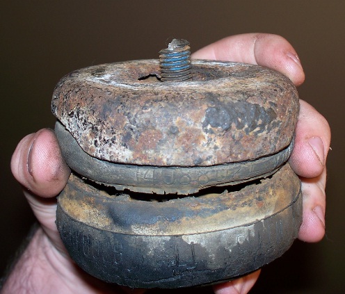

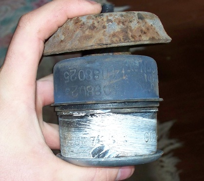

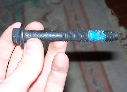

    Heres a few pics.

      i imagine if they were sloppy enough, you could have gotten enough room for the momentum needed to snap the bolts

                  LOL ya my luck does suck, i mean look i sheared my subframe bolts lol ive never heard of that happening.

                      My occasional clunk is gone. It was definitely coming from the drivers side rear bushing which was basically destroyed. I didn't take pics but the rear bushings were both pretty bad, the fronts looked half decent.
