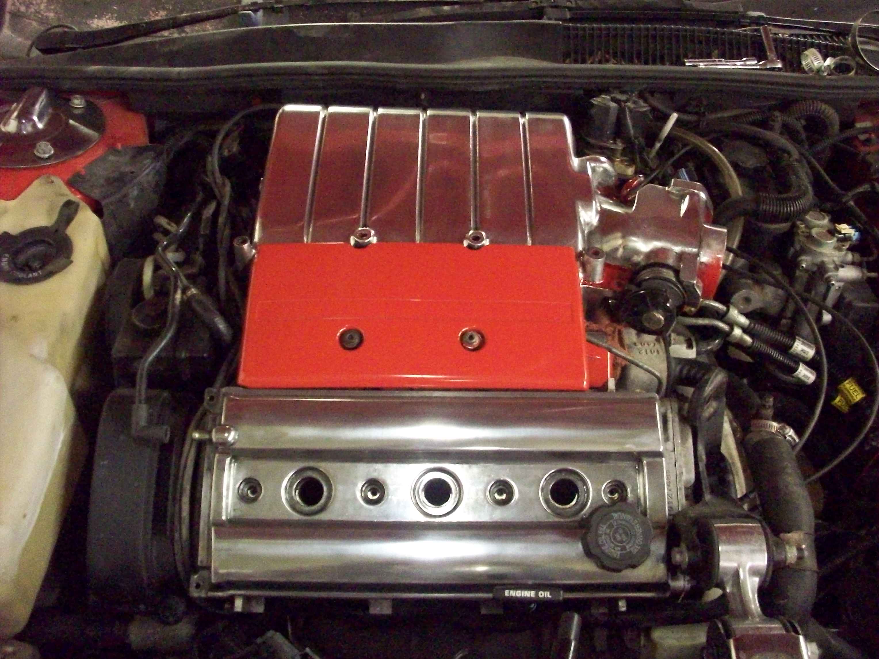

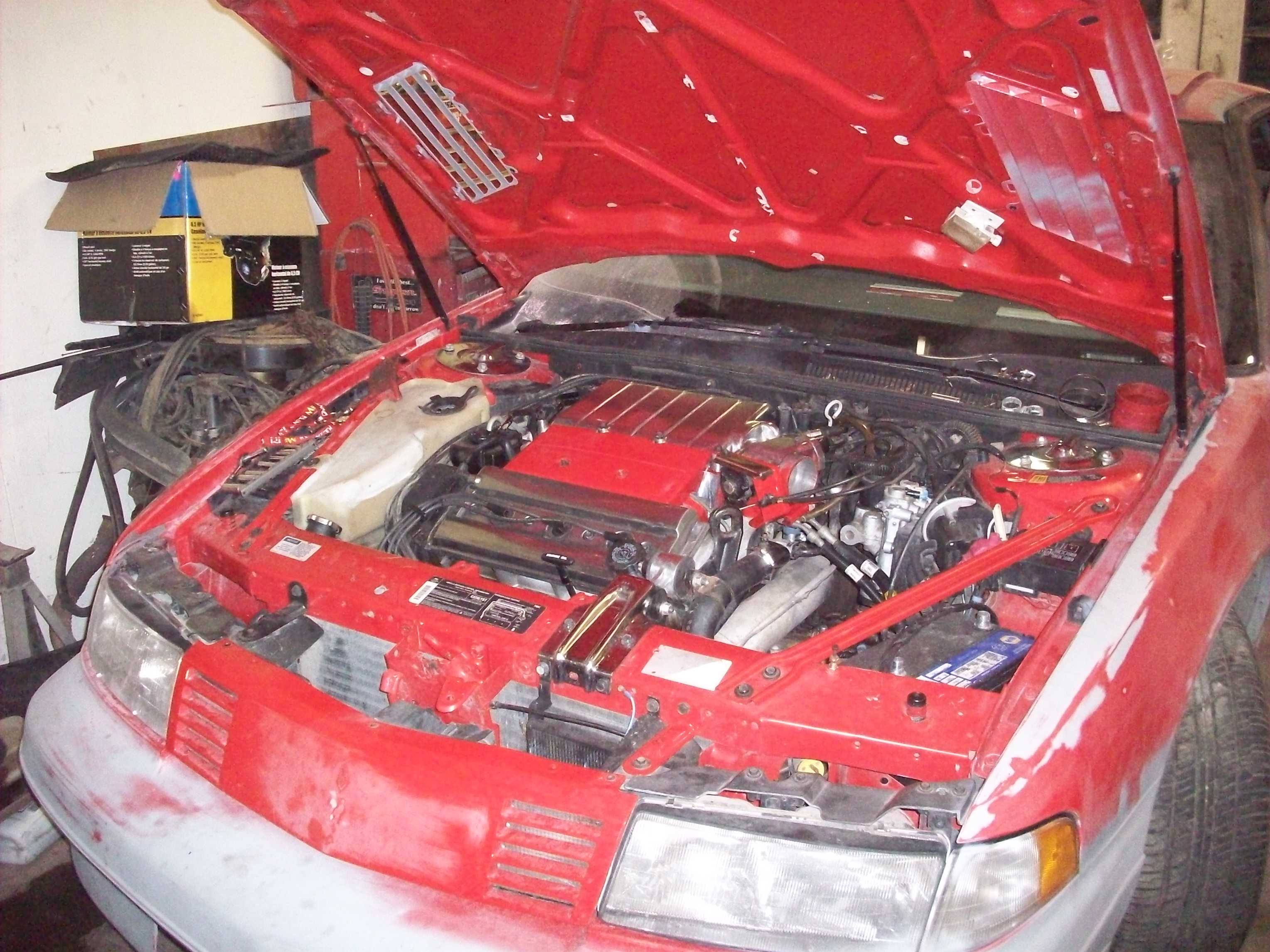

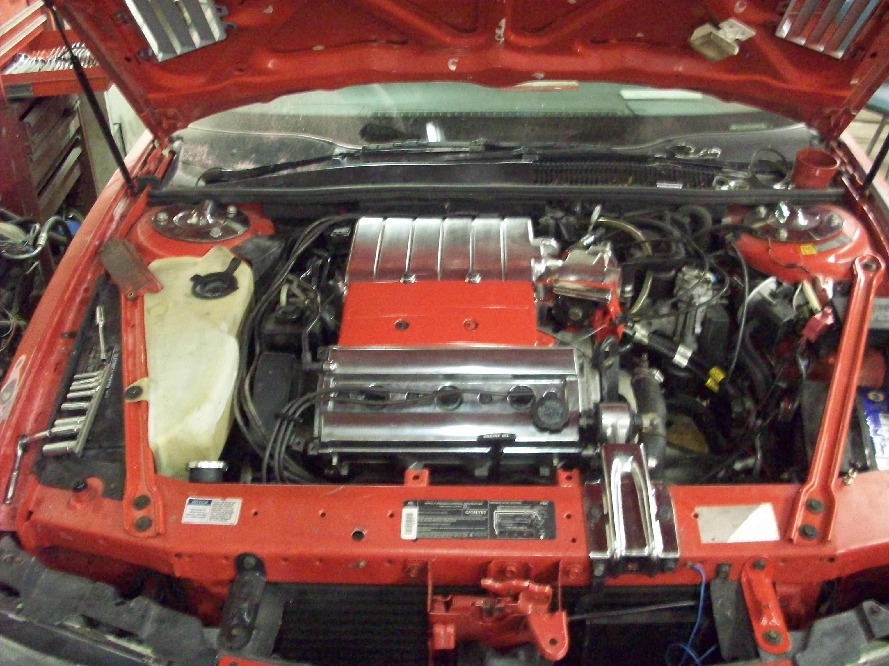

    let me know what you guys think of the polished strut tower covers front motor mount and bracket,throttle cable cover,intake and valve cover

      That's tight. What did you use to polish them
        1st-spray with paint remover(aircraft quality)
        2nd-you need to get rid of all casting bumps(roughness).
        for the top of the intake i used a 8 inch orbital sander,in the grooves i used a dremel.
        sand with 80 grit sand paper,moving on to 120,320,400,800,1000 and finnaly 1500 grit(there is no need for 2000 grit.
        3rd-polish the shit out of it
        4th-high temp clear coat.(so you dont have to keep polishing it every week)
        dont polish by hand either,use an air tool,or drill.
        mothers power ball works good.i personally use a 3inch polishing pad on a 2inch arbor for my die grinder
        i personally dont like the polishing compounds you can buy(blue,brown,green,white,ect.
        i just use AUTOSOL.ive tried lots and it seems to be best
