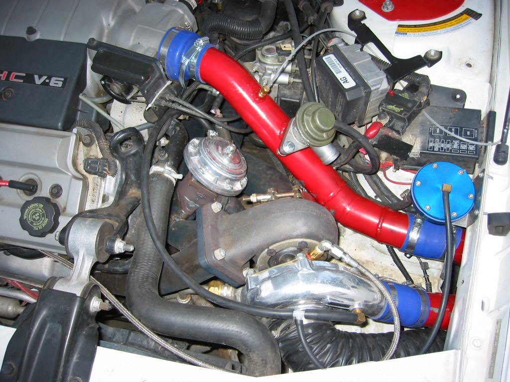

            Custom x-over/downpipe and charge pipes and your boosted (for the most part) like so... (my car)

                  There are a few of us with supercharged or turbocharged 3.4's. It's not easy or cheap. At a minimum for a VERY basic turbo setup you need:
                  Turbo, wagtegate, all intake and exhaust piping, silicone couplers, hose clamps, a new air filter, oil feed and return lines, a downpipe, a wastegate dump tube, lots of little hoses and fittings, a FMU, and a various gaskets and other parts that I'm forgetting.

                        A different MAP sensor and chip are not necessary for a basic kit. He can use either a MAP clamp or a check valve before the MAP sensor. The FMU will take care of fueling under boost. For ignition, you're assuming that the factory left some safety margin, you're running better fuel, and that you are running low boost.
                        My feed line for the FMU came from the fuel rail and the return went straight back into the stock aluminum return line.

                            Here's my old setup with the FMU and smaller piping.
