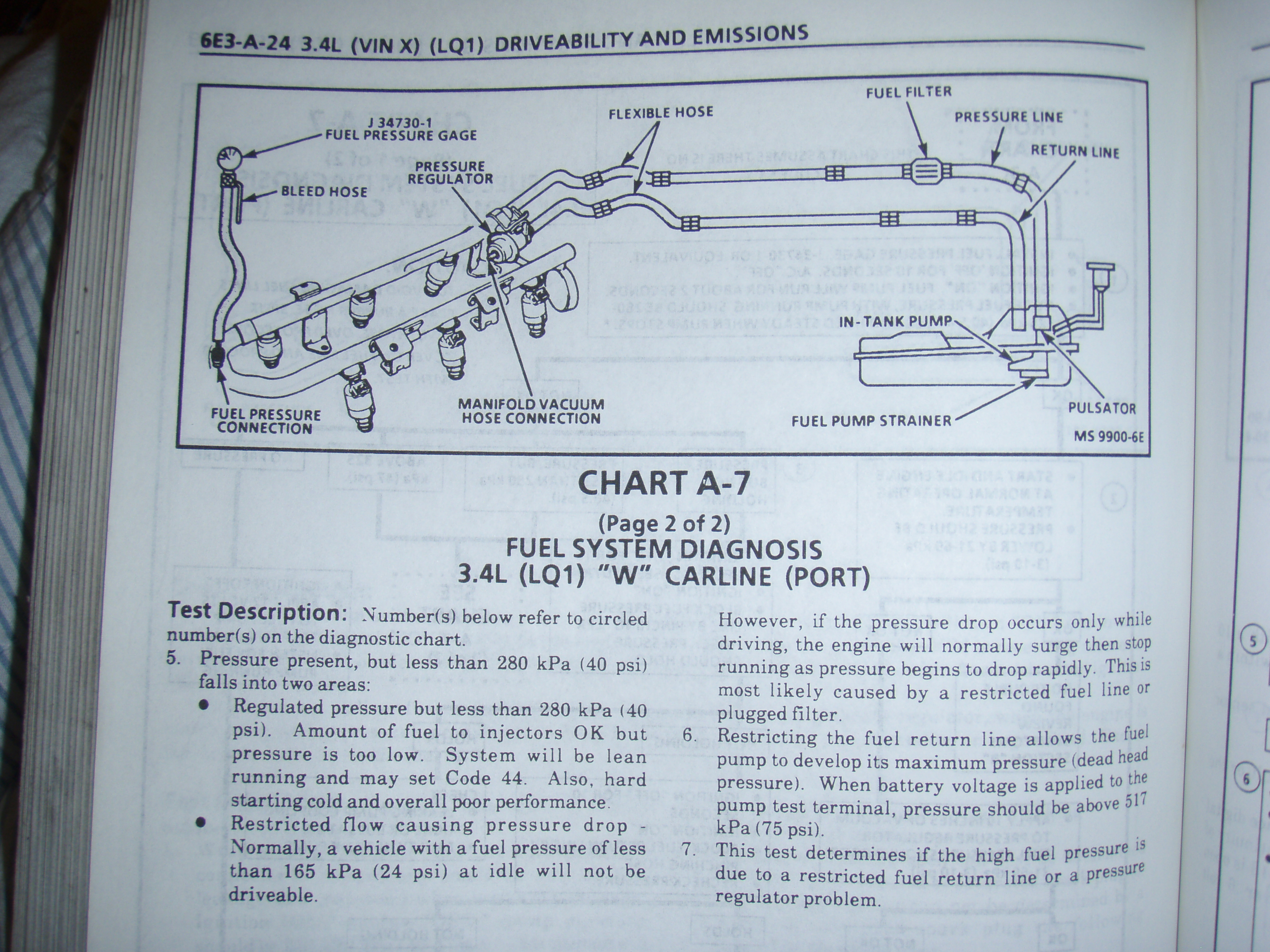

                - Car struggles to start after it has sat more than a half an hour or so, but 7 hours or more and it starts right up.
                I believe this is called heatsoak the air in the intake heats up so much it is much less dense and harder to start initially which partially floods the engine making the problem worse. My brothers old beretta used to do this especially putting in clutch to turn off the highway. he would just hold the the throttle wide open and it would cycle new air faster and would start better. I can't remember what he did to fix it though.
                haynes lists possible solutions as :
                air filter clogged ( I hope you keep a clean filter )
                fuel not reaching the fuel injection system ( low pressure? maybe fuel filter is clogged; once again)
                Corroded battery connections ( this is an easy check which you should have done from the start )
                Here's the repair flow chart from the GM service manual for my 91 your 93 should be the same. much more useful than haynes.

                  That's quite an interesting concept there. I would also check to see if you have the right fuel volume. A pump can give the right pressure, but not be pushing enough volume through the lines.
                    The check valve that is supposed to hold the fuel pressure has failed. Question now is where that lives... fuel pump? Regulator? Elsewhere? The fuel pressure test also revealed that it takes an unusually long time for the pump to reach full pressure (~3 seconds). Either way I'm pretty sure I'm looking at a fuel pump problem.
