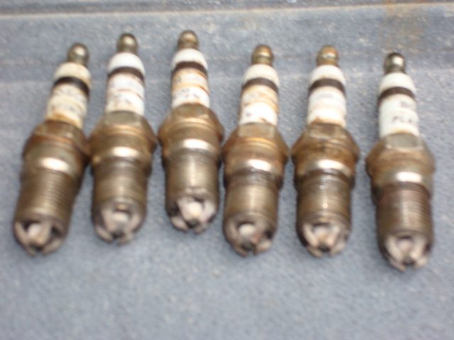

    WTF is going on ? those 4-tip plugs are what GM uses now in all their cars, as "lifetime plugs"- military aircraft use them because they are the most reliable spark plug ever made, for flying long distances 1000's of miles over ocean and mountain ranges- because up there, if a plug fouls, you fall 5 miles to your death- you can't just pull over to the side of the road ! the more electrodes a plug has, the least chance there is to foul one- if one gets fouled there are the other 3 to keep right on sparking- I've tried these plugs and they are the best IMHO
    if you're electrode was gone from using them, you had other problems, i.e. lean condition or engine detonation that created excessive heat and burned the electrode off- this was most likely caused by putting a non-stock ECM prom chip and program in, as the most likely culprit- I have run those plugs for years with no problems, and when I remove them after 50,000 miles, they can be put back in and still run more, here's a pic of my last set with 50K on them- and yes, they are out of my 3.4 DOHC engine
    if you are burning electrodes off spark plugs, you're doing something else wrong

      The Bosch plugs don't work in GM cars because of the DIS ignition or "waste spark" system. When you have a cylinder on the combustion stroke, the coil fires so the plug will spark. But, it also fires the other plug that's connected to it at the same time, and that cylinder is on the intake stroke, so the plugs get fired twice as often as a normal car's plug would, and the Bosch's can't handle it because they use a thin metal electrode and they can't cool down fast enough between sparks. If you were running platinum +4s in your DOHC and they still worked as good and looked as good as you say, I'd say your ignition system may not be producing as much voltage as it should. I ran Platinum +4s in my car once, and they worked great for about 10K, and after that they performed like ordinary worn out plugs.
