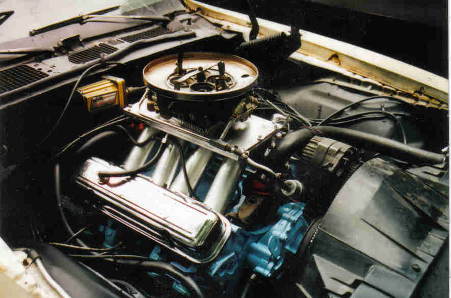

      see attachment- 455 Pontiac + .060" = 470 CID- tunnel ram- Dominator 1150- that's what I'm accustomed to tinkering with, not these newer rigs with no access space

        big block....drool. what car is that in btw 74 firebird/formula/TA???

          Firebird is a 1970, bought it back around 1985
